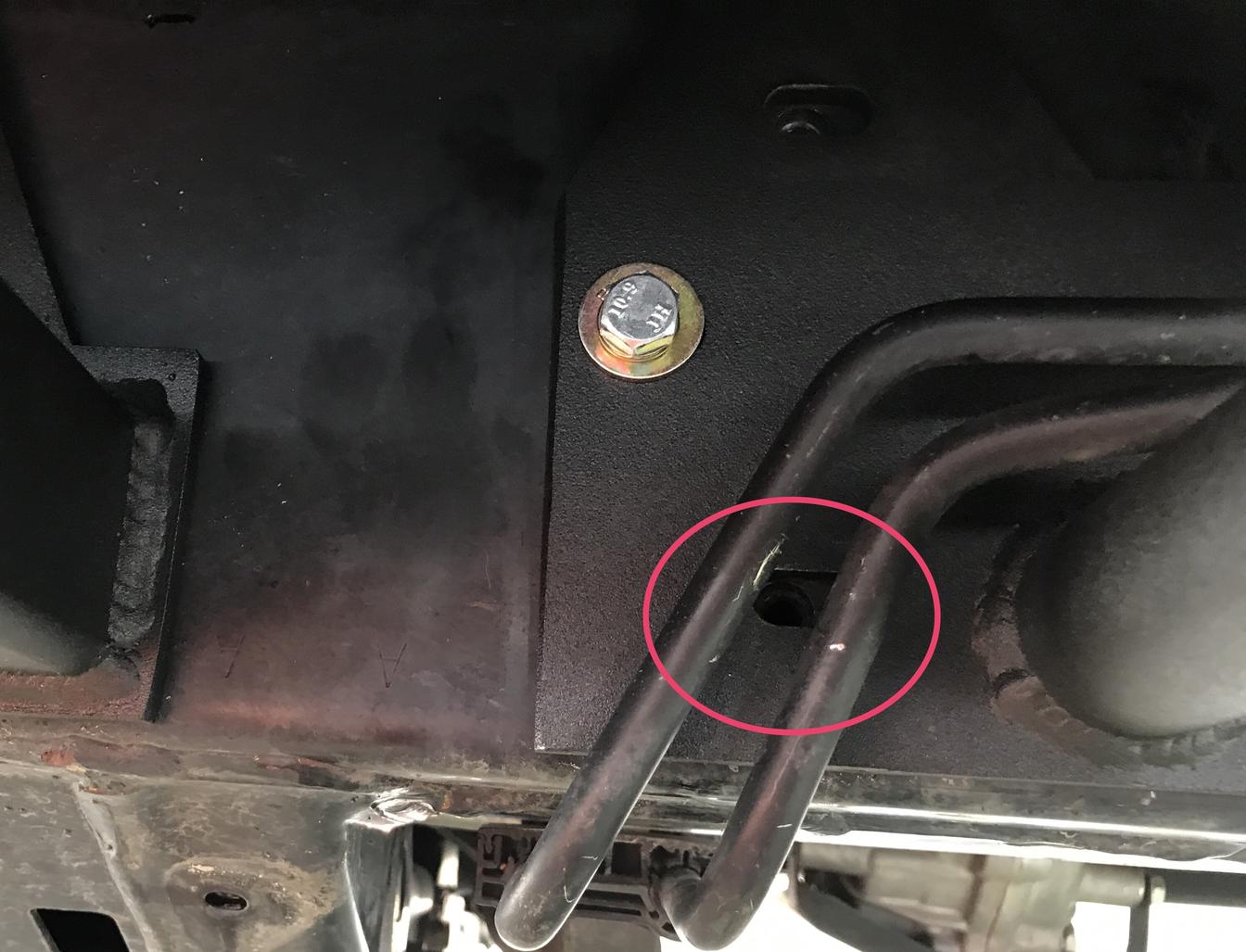

I've had one issue and that's figuring it how to get the bolt into this hole and tightening it. I get the impression it is not used, but not sure as I can't get the lines far away enough or split them apart far enough.

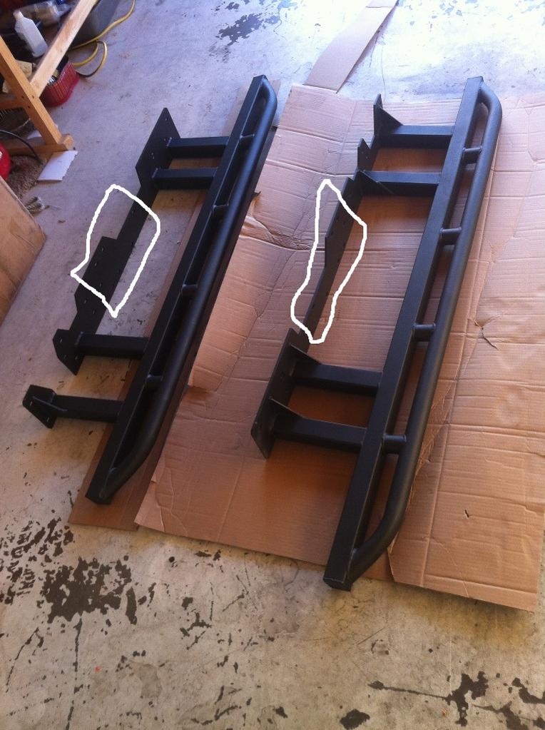

I ordered my sliders through All-Pro, clearly stated in order I had the KDSS system. Sliders were delivered fairly quickly. I then proceeded to degrease with acetone, prime, and rattle can paint sliders. The driver side slider was not manufactured correctly by All-Pro/Trail Gear, their gussets were interfering with the rear KDSS lines, pulling them too far away from the frame. I called All-Pro, and after a few failed attempts to get some answers, finally was put in contact with their "tech" guy. He at first insisted the order was correct, said the pictures in their install directions link were from a fellow employees KDSS truck. The pictures in their directions were clearly different from what I had received. He promised to look into things further, two days later, still no reply from him or All-Pro. I had to contact him, again to plead my case. Eventually, he said the correct KDSS slider would be shipped out, "his guys" were supposed to contact me, of course they did not. No apology, after his assistance, but I did request a small refund for the time, materials related to the painting of the incorrectly sent driver side slider, as I would have to repeat the process of degreasing, primer, paint, and install once again . All-Pro/Trail Gear would not agree to my slight refund request, per sales manager Jess Juarez.
