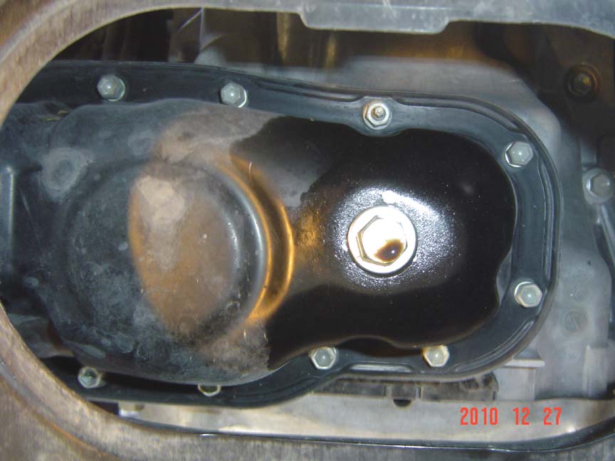

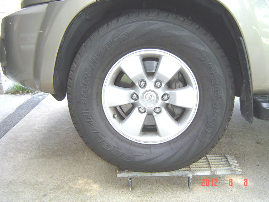

A V6 oil pan attached. I inspect my pan’s threads, after noticing a messy plug before a change (after my 07, 43,000 mi Certified purchase in 2010). No noticeable problems or a mess since with a 25-30 ft lb torque, “that good sealed feel”. This is why I have always changed my oil, to know what’s done and possibly see other needs in advance. My one ramp was raised to get better looks and angle was welded behind the tire as a stop also.
