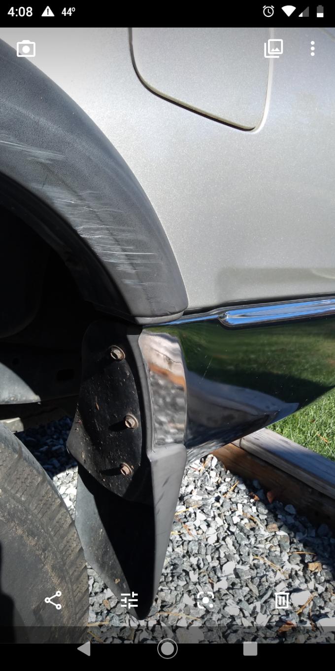

Does it look like there's a piece missing here? I just picked up a very nice 2000 sr5, but I don't think it's supposed to look like this. Does anyone know a part number? Is this the wrong mud flap?

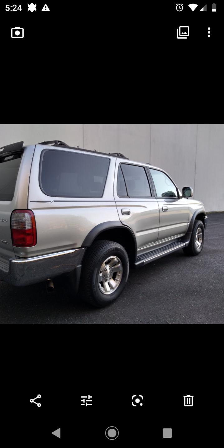

Do you have photo of the entire side???
I cant tell if those are factory flares or not. :-(
Assuming those are the original flares on the side, it probably has a replaced 'wrong' rear mudflap. The correct ones reach up to the fender trim:
Yup wrong mud flap. Looks more like my silver one. I know of 3 different types of mudflap. The limited the black flares, and the non flare mud flap.
Looks exactly like [MENTION=71960]JohnMc[/MENTION] as well. :] . I am not 100% sure mine is OEM on my silver but looks like they are. :)
Sent from my SM-J337V using Tapatalk
I agree with JohnMc as I dont see the holes in the bumper for the flare mudflap. Are they there? Bumper most likely changed with wrong bumper sides and mudflaps.
Rear bumper extension has been replaced at some point. Not a huge deal since it's just cosmetic and they get dinged up pretty easy. They did put the wrong one on there with the wrong mudflap though, so if you want to put the right one on there you'll need to find an SR5 trimed rear bumper extension for that side. I actually might have that exact trim in my backyard on the parts vehicle.
Truck was rear ended. They ordered mud flaps from Toyota and got sent those because that is all that's left in stock in the country. Find a used set.
Thanks for the replies. Yes, the other side is the same. No holes in the bumper extensions. I guess I'll start looking for part outs.
