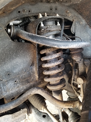

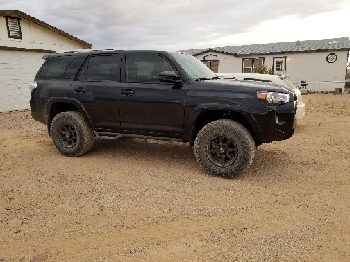

The truck, 2017 SR5. Bought it used, 20k miles, and I've done nothing to the suspension. Yet. Also, currently no aftermarket bumpers or skid plates at the moment.
It has a 1½" spacer on top of the strut, which appears to be OEM.

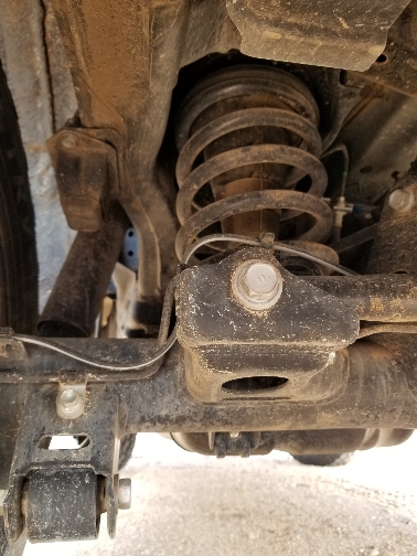

I have no idea if there's a spacer in the rear as I assume it's hidden.
All four corners measure 22¼" to 22½" hub center to fender.
How much am I lifted front and/or rear?

All rigs are a bit different and without knowing exactly what the stock measurements were there's a bit of room for error. That being said about 2-2.5" font and about 1-1.5" rear

So should I get really curious and check the rear, I should find a spacer on the top or bottom of the spring. Is there an isolator of some kind that comes original?

Geometry.... just draw it out and it will make sense to you.

The geometry on these equates to almost a 2:1 on lift - aka if you add 1" to the coil you SHOULD gain 2" at the wheels - due to sag on OEM coils etc, and your hub to fender measurements vs. what I have I'd say you are pulling a 2.5" lift (assume 20" hub to fender as a baseline measurement - some 4Runners are less, some are a hair higher)
I agree with the 2.5 up front. I don’t think you have any lift in the rear.

I forgot to comment on the rear - fully agree with you on nothing in the rear. my measurements stock in the rear were at 22/22.25.
