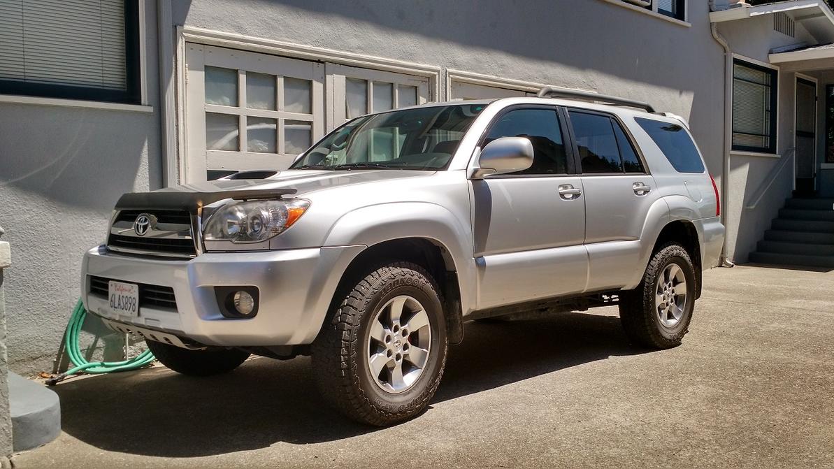

The bolt patterns are the same on 5th gen wheels but they have less offset so the wheels will stick a bit more. Im on 14' sr5 wheels and they stick out about an 1" more so more than the 06' sr5 wheels they replaced theres a bit more clearance between my tires and the UCA. And they look nice..
