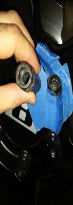

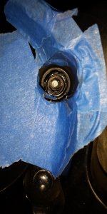

I got the lug stud and lug nut off last night. I drilled through the lug nut into the stud. First I drilled straight through the lug nut key with multiple bit sizes until I had a 1/2in hole through it. I then held the lug nut/ stud from spinning by holding the key with vise grips while drilling into the lug stud. I started small and worked my way up until the stud was close to paper thin, then I removed the other lug nuts and grabbed the wheel and snapped the problem lug off.

Glad to hear you got it off. Can you see any reason why it came loose like that?
Looking at the old stud and everything I cant determine why it happened. I can only speculate that the lug was cross threaded and got stuck then I hit it with an impact gun to tighten it. But even thats hard for me to believe cause I start all the lugs by hand with the lug nut key. So its just one of those things Ill never know why it happened.
