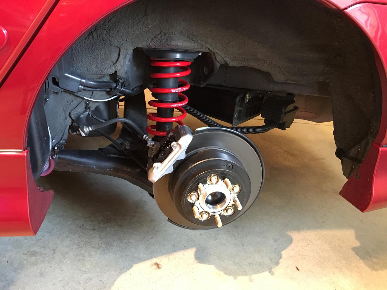

Recently Ithiba sent me an email noting they aren't listed on their site, but they do have them available. Installed Ithiba spacers on my X-RS about 10 years ago to fine tune track width and handling. This car is exposed to extreme lateral forces, also have been up over 130 mph with no issue or vibration. Very happy with their product. They are billet aluminum, hub centric bare aluminum ( no coating ), mine came with grade 5 conical lug nuts. I painted the outer edge with POR15 to match the hubs.

Some pics of the Itchibas on my X-RS

The purpose of the spacers on the X-RS was to fine tune handling. Weight center, track width, loading of weight and slip angle of a particular wheel in high speed sweepers and relatively lower speed sharp turns. Basically to fine tune directional change for better predictably and grip.

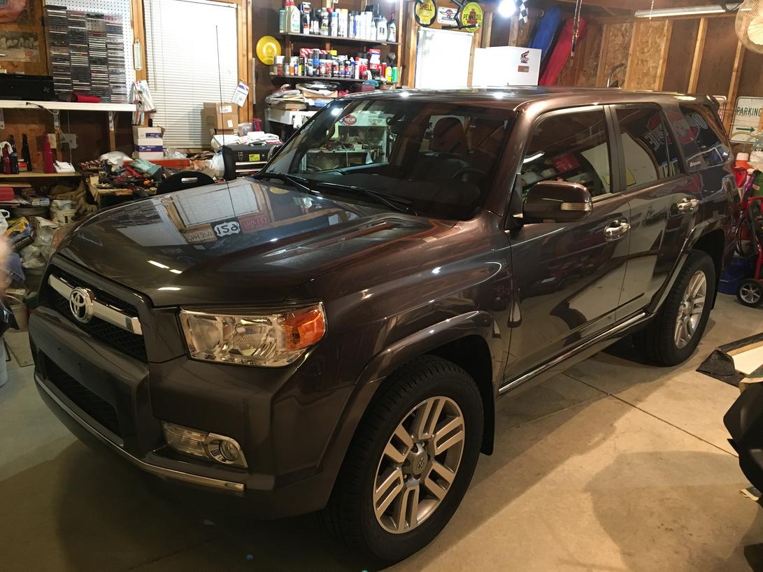

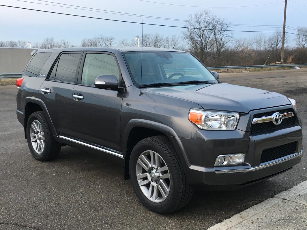

On the 4Runner it is more for looks. I'm running 275/55-20's on stock Limited rims and 19mm spacers. Just installed spacers last night, haven't driven it yet.
They should change the on road feel though a bit.
For looks, for now.

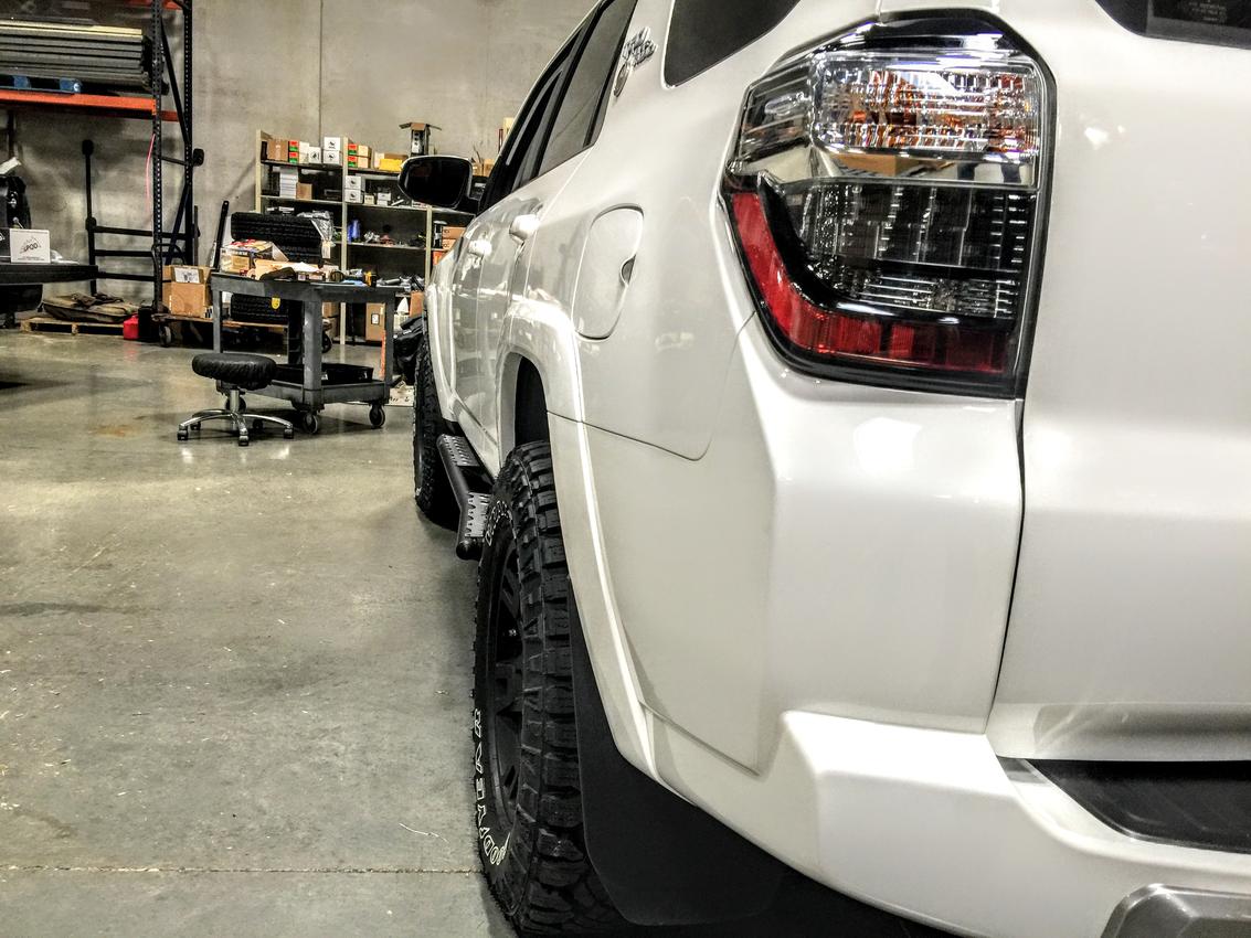

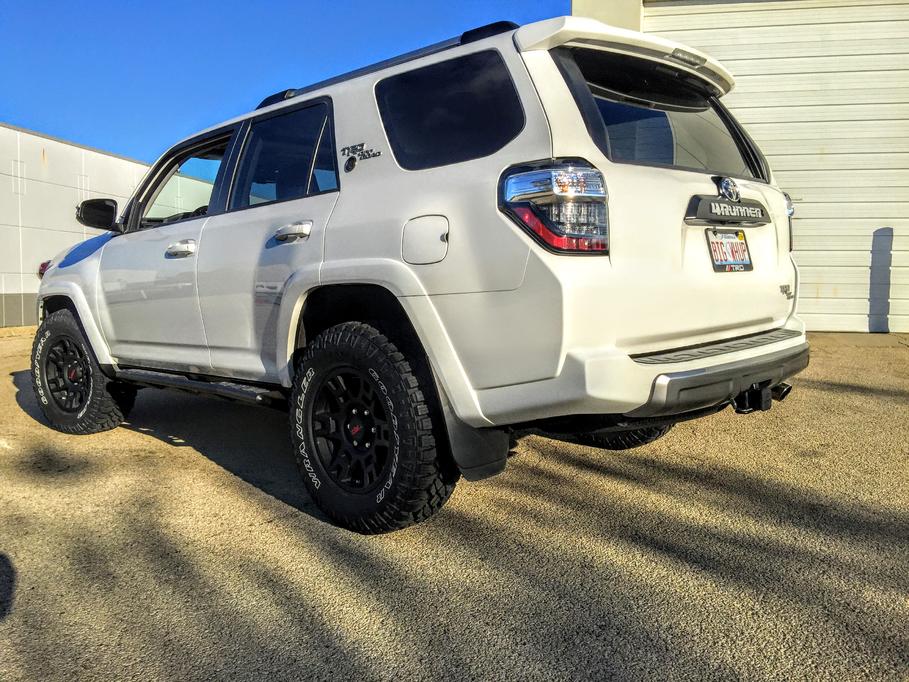

I put 1.25" BORA spacers on mine for a few reasons that really have little to do with performance. First, I have the SEMA Pro wheels, second, I put 265 70 R17 OWL Duratracs on them and lastly I have no lift, but C4 Fab sliders installed. In this combination the look of the wheel tire combination without the spacers would have looked odd to me and I like to fill out the wheel wells but not replace the Pro wheels, cuz I really like them. I can eventually move to a lift and new wheel combo, but for now I didn't mind the cost of the spacers. Since I was going for it, I went for the full 1.25" rather than buy the smaller offset ones and regret not going all the way. I think its just right now.
I did modify the front mud flaps and they still rubbed a little during articulation of the front suspension which bugged me so I pulled them off. No regrets, they really don't do much now with the tires pushed outward.
This setup is for my newbie off roading trials. I want to see exactly what I can accomplish off road with the vehicle like this before I spend money on the lift and wheels. I am pretty confident I can get to the places I want like this, and for extra peace of mind I have the RCI skids coming but they wont be here in time to be installed before our trip to Colorado.

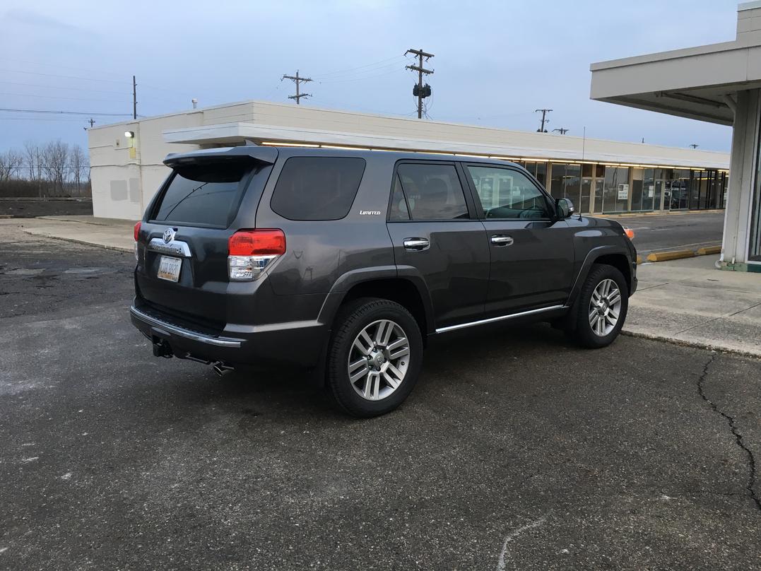

Did about 16 freeway miles, no vibration . Had it up to 75-80.

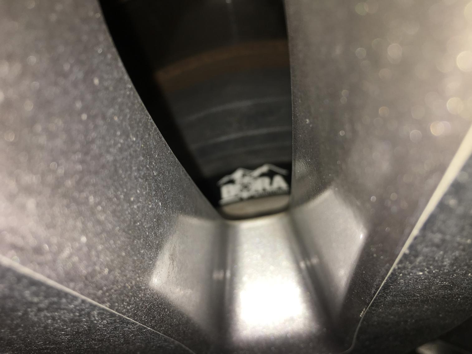

These are Bora 3/4" spacers & 275/55-20 tires, happy with the results..

Did you have to cut the studs shorter or did they fit inside the machining of the OEM wheels? I don't recall seeing anyone run a 3/4 spacer before.

If I would have had to cut the studs on the hub, I would have returned the spacers. Factory studs fit inside cutouts on the stock rims. Used green sleeve-lock on studs to mount the spacers. It's a high strength green lock tight.
Have used it for years, works excellent.
