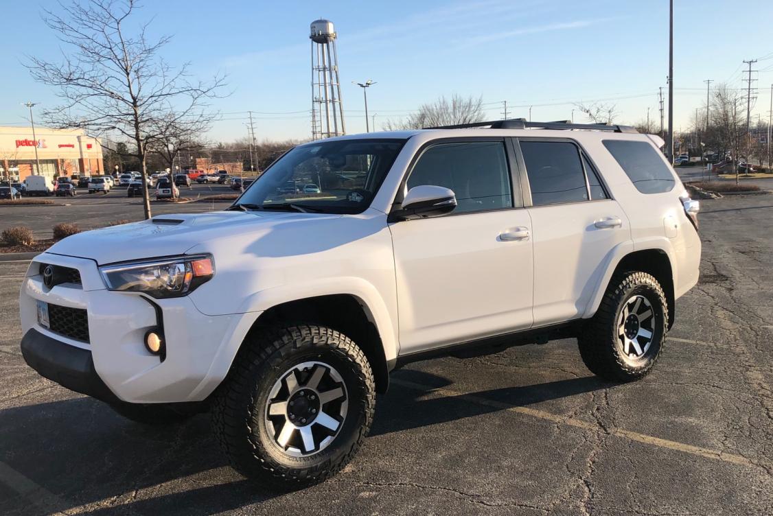

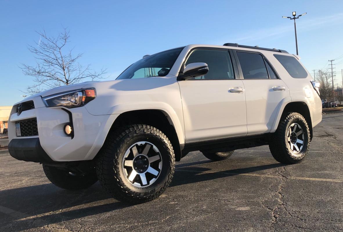

I have the T-12's and sometimes I wish I went with the T-13's to keep a little more rake. The truck rides great with 5100's and the T-1 coil up front with the T-12 in the rear.
How much did you end up gaining from the lift? 3rd row seats?

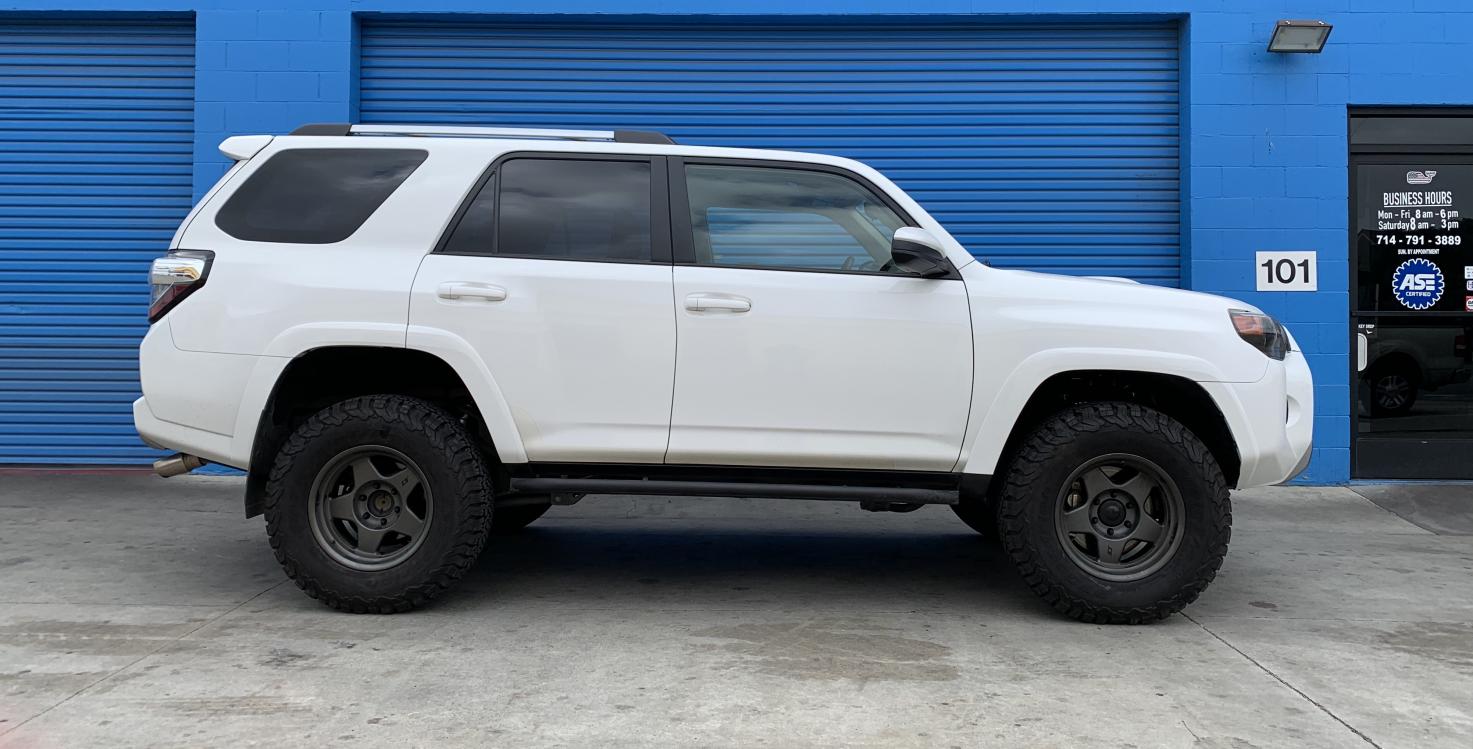

Running T1 coils up front, and OME 2895E rear coils for 2.5” and 2” respectively. Eibach Pro shocks all around. No reverse rake with boat hitched up.

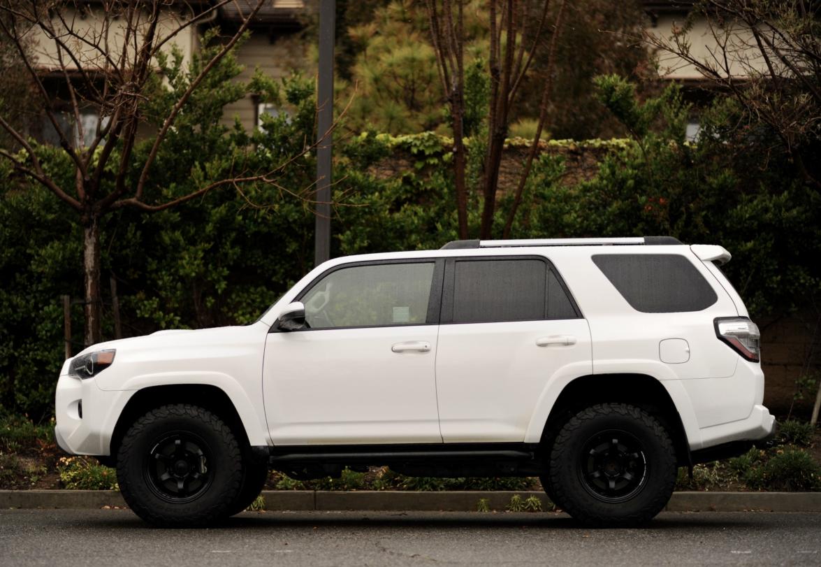

T1’s in the front on Bilstein 5100’s set to ‘0’. Rears are T12’s on 5100’s. I’d go T12’s if I had the 3rd row.
The OME 2895 have been on my radar but they have a much higher spring rate (260). Assumed they would be much firmer then the T12 at 200lbs.
I don’t notice excessive bounce or a super firm ride, they settled in nicely. Much better than the factory XREAS system I removed.
