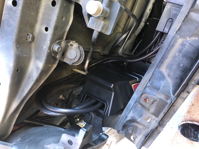

Mine's wireless but we relocated the control pack up towards the driver's corner of the engine bay.
Mine is relocated to the right support strut for the nose in front of the radiator.

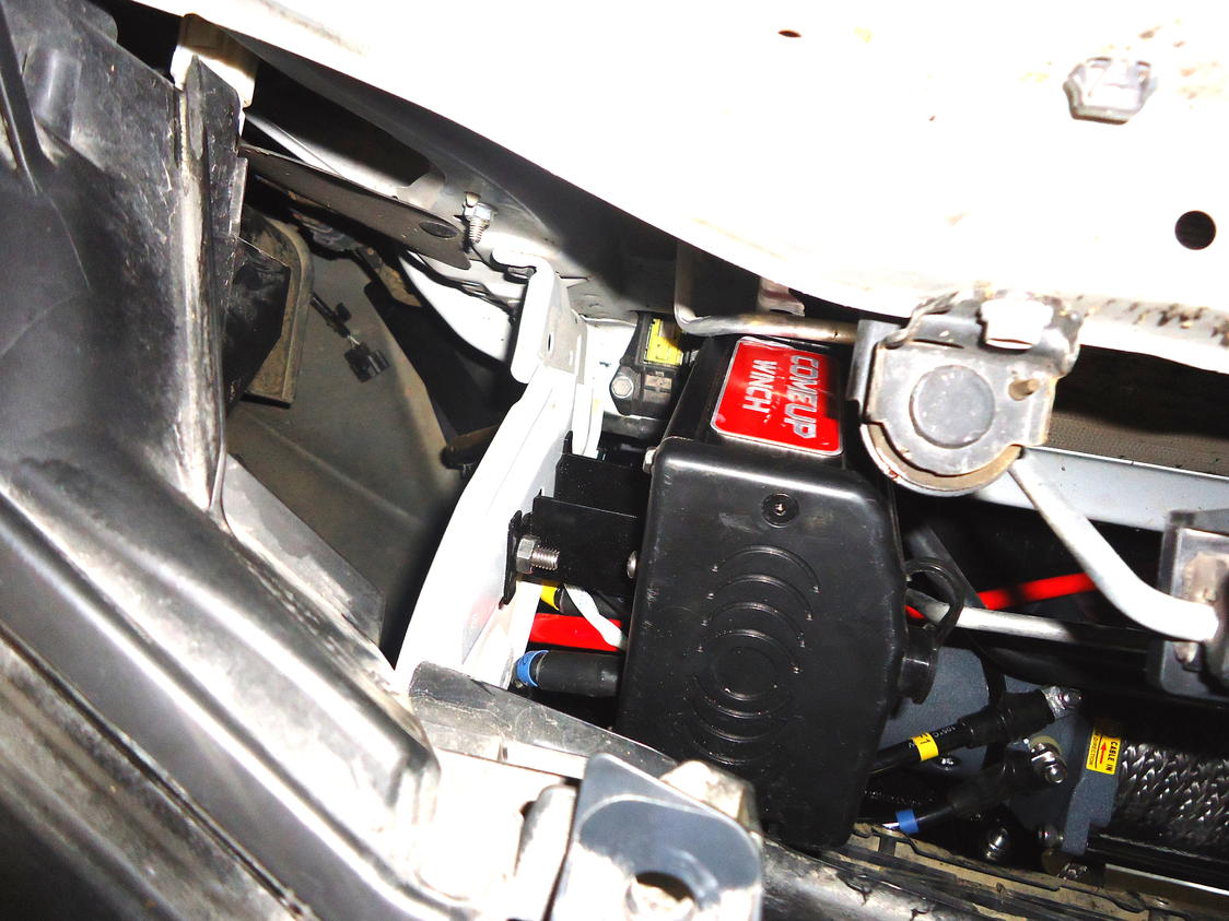

Did something very similar but flipped it around to use the dovetails on the other side of the box. No drilling required, just 3x 10mm bolts and washers.

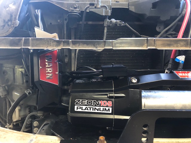

I would've done something similar to this, but the control pack doesn't fit on the winch in the Demello bumper. I ended up doing what [MENTION=110414]Taco04[/MENTION] did as a temporary solution. It works, but that top part of the grill doesn't sit flush anymore, so I need to figure something else out. Any more ideas?

Your solenoid probably will fit right on the winch where it comes. I would not move it if it fits. Shorter power cables = :) No reason to reinvent the wheel here. The closer to the winch motor the solenoids are the better.
Just remote mount the actual plug with smaller 14ish guage wires and run that up to somewhere easy to plug in.

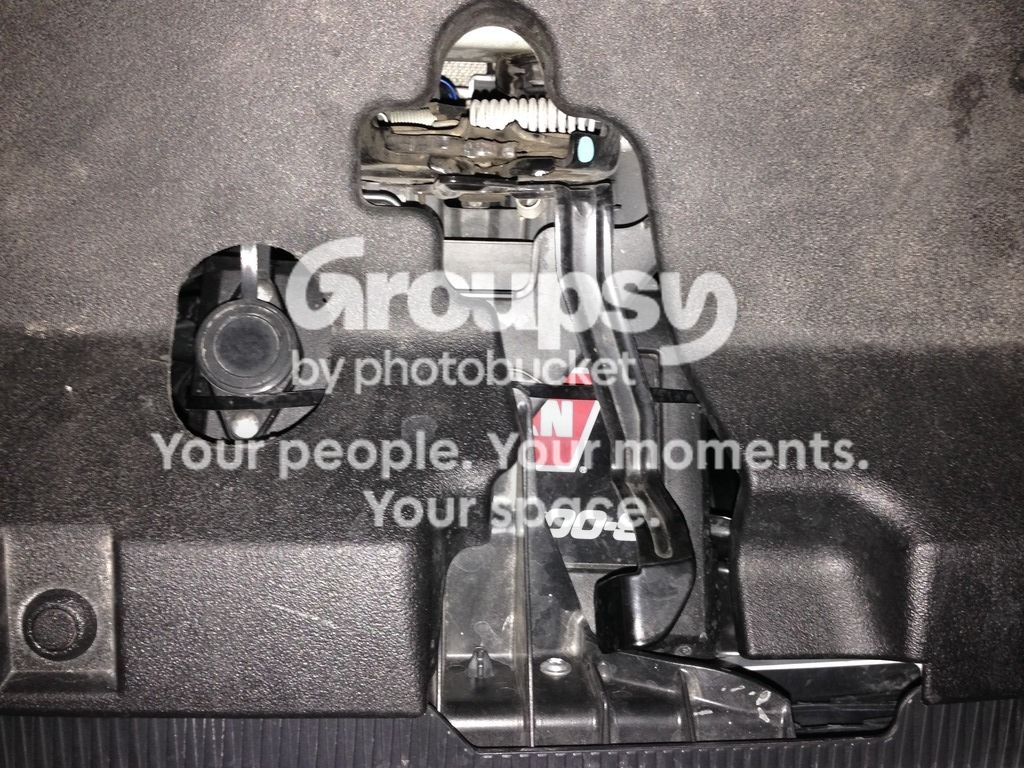

Mine is mounted on the winch. The dealer cut two holes in the black plastic under the hood, one above the solenoid and one above the clutch lever. I can easily reach the solenoid plug and the clutch lever by just opening the hood and reaching through the holes.. The 12' remote cable comes out through one of the grill openings allowing the hood to be closed. On mine the cable is not much of an issue because I have wireless.

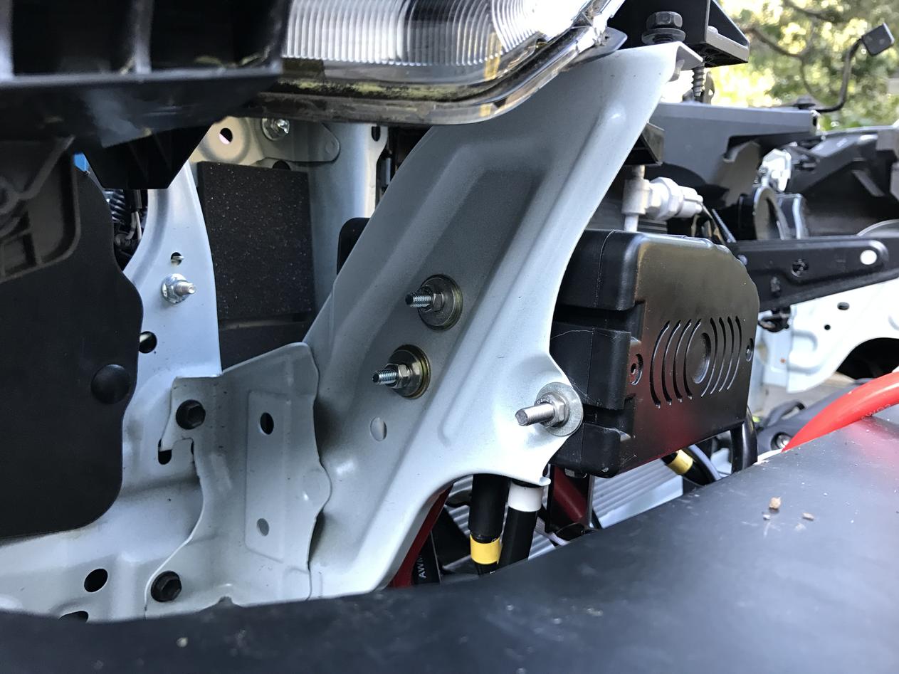

As others have done, I mounted on the left side bracket. No holes needed drilling just lined up existing holes and ran some bolts thru it.
However, I am probably going to move it. Mine is wireless, but it just doesn't seem right where it is. SO I will probably extend the wireing and move it up farther into the engine bay.
