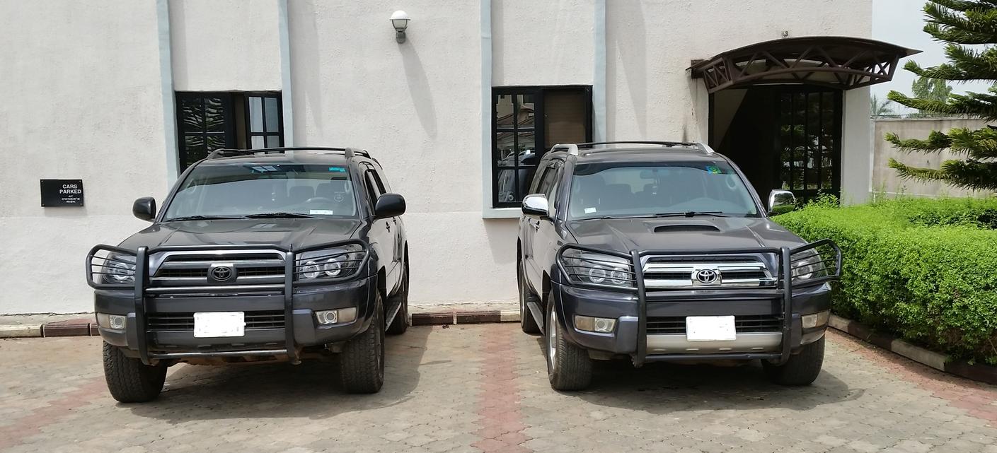

comparism shot, runner on the left with rancho pre assembled quick lift struts...and normal runner with factory shocks
