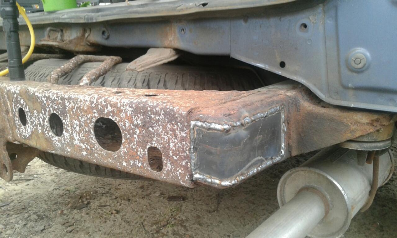

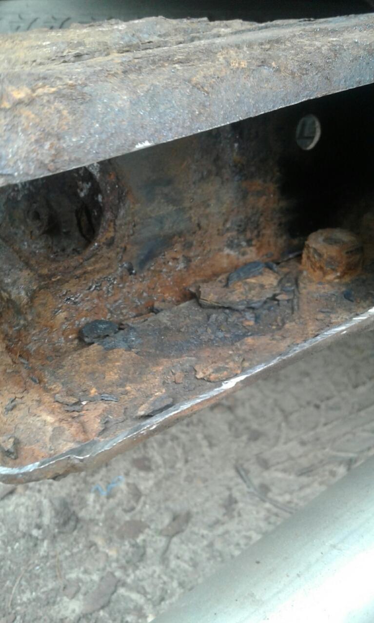

So one of these rust threads got me to finally remove the rear bumper cover to make sure my hitch was still well supported. The pointy hammer created some nice holes in the corners on both sides. Fist pic is after cutting the metal back to solid steel. You can see in this picture that they can rust from the inside out. It doesn't help that there was 5 pounds of sand packed into this area, the pic is after cleaning it out some and hitting it with the scaler. This section looked decent from the outside until I rapped on it. Second pic is one side repaired, you can see some of the rust wafers on the ground. I did bore some access holes into the new steel and sprayed fluid film in there. Plus rust trapped the exterior. It should last me awhile this way but I think oiling the frame will become a yearly thing to do.
