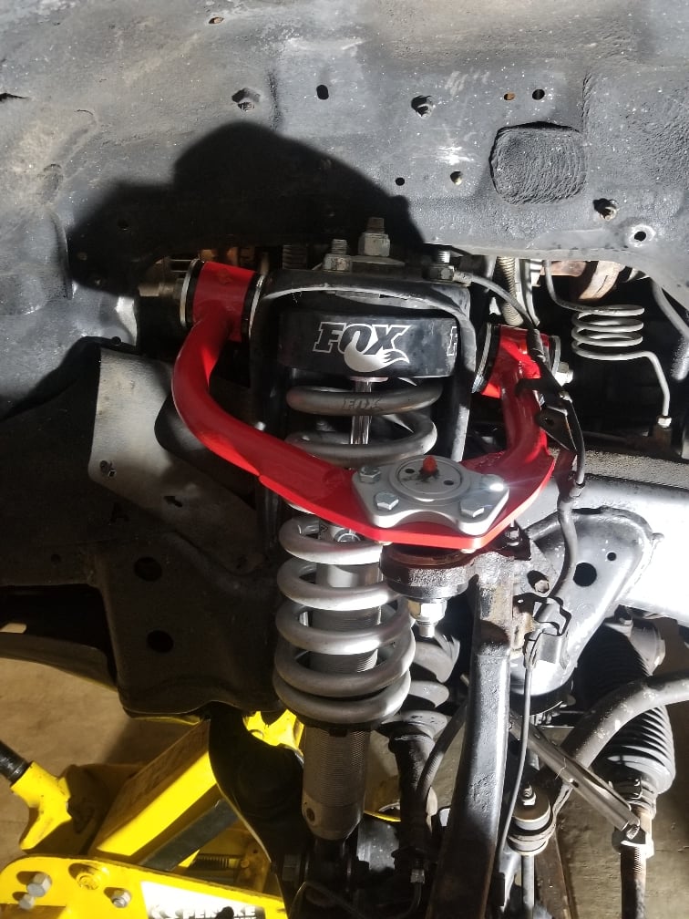

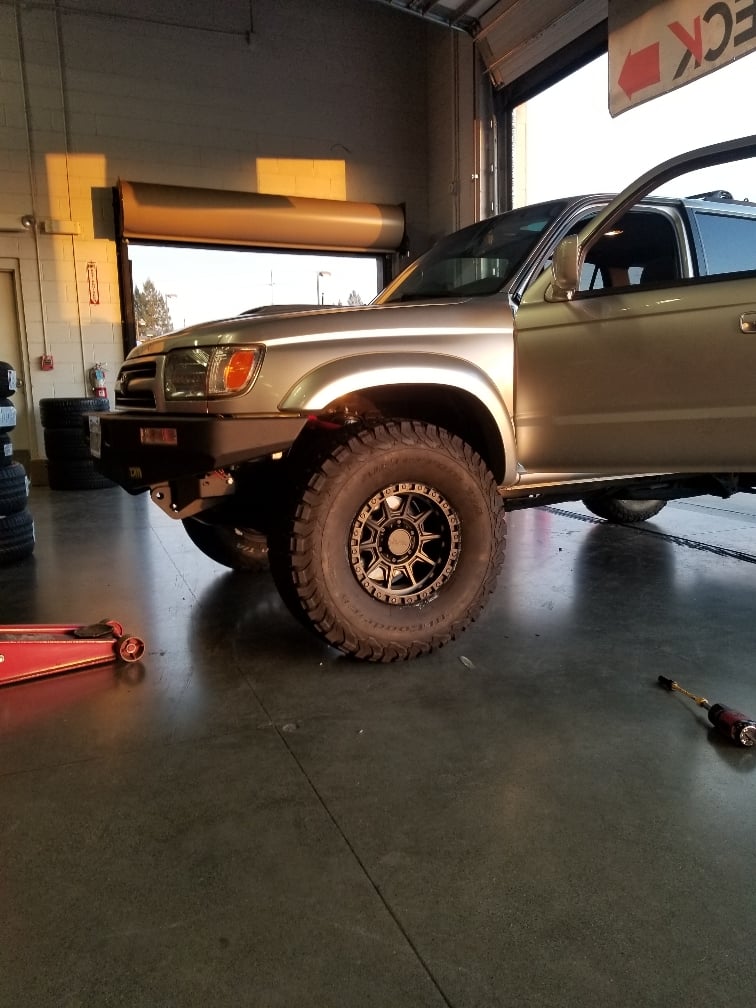

I'm running the 2.0s with a tjm front bumper no winch. I have them turned up maybe .5 inch but they are plenty capable of being turned up more. Even cranked up they ride like butter. I definitely feel like I could turn them up another .5 inch and they would ride fine. You could always buy longer, stiffer coils for a 2.0 body coilover for your front weight. I have thought about a small spacer on top and looking at the extended lengths, a .5 inch spacer would put them to about the same length as the extended travel 2.5s.
Pics are with 315/75/16s
