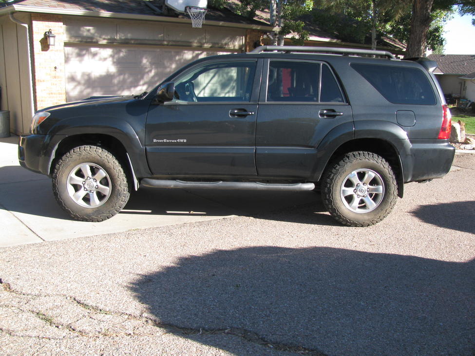

Sorry for veering off topic a bit here.... any pics of your runner with the 255 KO2's?
Here you go.
I like the size. It's a full 32" diameter but the slightly narrower width makes it fit well with no rubbing and theoretically should be good on packed snow and ice.
