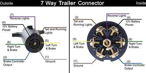

2021 4Runner TRD Pro, has 7 pin connector on the back.
I'm guessing 12vdc power on one of the pins.
Anyone know how many amps at that charging pin?

my 2012 has a 40amp fuse for the trailer brake. the vehicle should send 14amps to the 7pin. you can test this with a multimeter

there are lots of videos. I think I used this one when I was testing my 7pin and 4pin. you need to verify the 7pin has power even when the vehicle is off. I do not think it does but I could be wrong
I think you are correct, from other reading I believe there is a fuse/relay so when the 4R is not running no power to the 7 pin.
