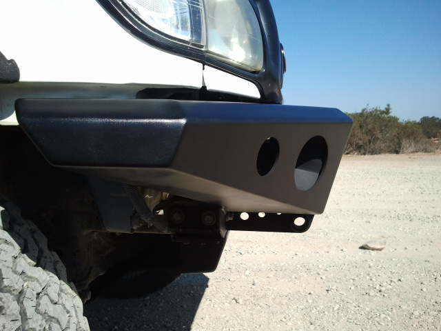

Look at the pics I posted above. You will have to cut your frame flush with the front body mounts if you want to make it fit.

Our frames extend out further than the what you see in the pic above.

Yes and no, 4runner frames and just a little bit longer up front, but you can cut it to make it fit, and the bumper bracket are just a little bit wider but a BFH can fix that, and we do have the AC line where tacos don't how do i know? because this bumper is on my truck
