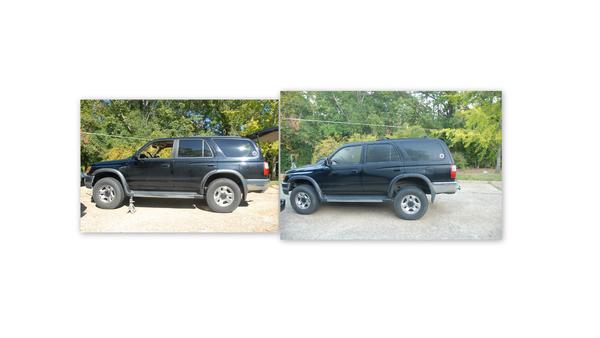

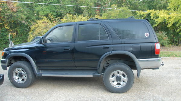

I put on Tundra coilovers from a 2006 DC tundra and Lexus coils with LC shocks on the rear. I did it by myself and it took about 4 hours for the front and 4 hours for the rear on two separate days. I did it at different times because I ordered the wrong shocks for the rear first go round.
I don't have the exact measurements with me, but the front lifted right at 1.5" and the rear 4". I hope it settles some, as others have experienced, because that's a bit higher than I would like. I guess I'll just throw some weight in there and see what happens.

Welcome! That is definitely a lot of rake you got! You really can't determine how much it's going to settle. You're just gonna have to wait and see. If you plan on adding a rear bumper and storage box, that will help to drop it down a bit.
