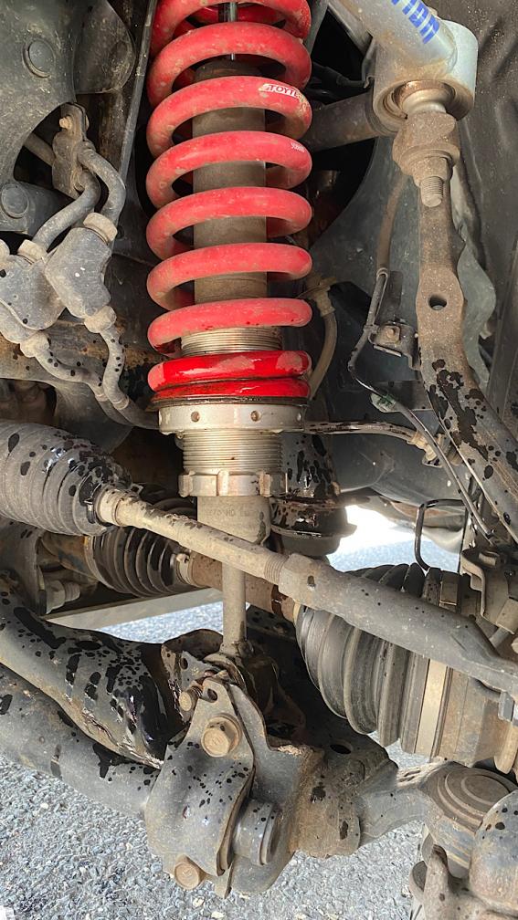

Installed a winch yesterday did the measurements and the it sagged 3/4 inch. From 23 to 22-1/4 inch. I’m running toytec ultimate lift kit with adjustable coilovers ( old version) The question is should I adjust them to go back to 23 inch maybe 23-1/2 or go with bilstein 6112 as an upgrade. What do you think?

How important is ¾" to you?
Will you now have to use the winch because of the installation?
Sent from my SM-G955U using Tapatalk
3/4 inch is not that bad hopefully it’s not gonna gag more, and of course i will use the winch the thing is that besides winch I also have slimline steel bumper and heavy sliders, that’s why I’m not sure if those coilovers will handle all the weight.
Your call. We went with 700 lb coils with our coilovers because we knew the bumper and winch were coming soon. I’d probably leave it unless it really bugs you.

As others have mentioned, you just have to upgrade to heavier coils if you don't mind the rake.
Now, whether or not you 'NEED" to upgrade your coils, is find the crappiest road near you with lots of potholes, and see if you bottom out easily. If you do, then you probably need to upgrade your coils. another way, is to push up and down on your bumper, and if its easy to move up and down with just your body weight..you probably need to upgrade your coils. Or go offroading, and if you get thrown all over the inside of your car like a pinada..you need to upgrade your coils...lol.

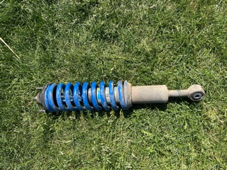

Here are my backup 6112’s I have 650# King springs mounted.
