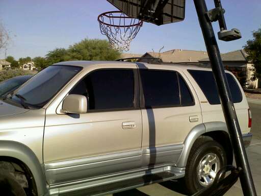

First window tint... My 4Runner has only privacy glass and its getting hot here in Phoenix, AZ. Just want to know how well this piracy glass actually cools down the inside of the truck? I have been told it offers no UV protection, is the true? I have the 4R scheduled to get the front windows tinted to match the back. Tint guy said ~20% and would charge $50. I did just notice though that there is a small amount of privacy tint on the front side windows. So just tint the two sides for $50 or all the windows for ~$150+.
In the end I want better sun protection, all the windows to match and still light enough to drive at night on trails. Here is what the windows currently look like...

Just your standard tint will help with the heat, but there are other options. You can get a UV tint, but it's pretty pricey. Another option is tinting your front windshield with a very light tint. I've heard (no firsthand experience) that doing so can greatly reduce the heat from the sun.

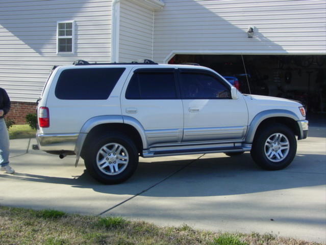

Hey there here is a shot of my tint as it is now. When running the AC it actually helps alot to maintain the temp, as well as repel heat.

Look at the great and UV rejection performance in the tint you buy, and go through a shop that offers a lifetime warranty on the job. It gets really expensive to have it taken off and redone
Our 4 runner was done in AZ as well. It was done with all the windows tinted including the back which was already done by the factory. It is dark though inside but looks sweet and repeals light in a great way.
Hope this helps you see it.

Go 20% all the way around. It will make the back windows darker but they will still match pretty closely to the front. I would recommend 3M Ceramic Series tint. 3M is the best in the biz when it comes to window tint. There are other brands out there, but from my experience 3M will last the longest and block a lot of heat.
For the windshield, I would do a 20% strip down to the AS1 line, then add a window shade. I have had an Eclipse window shade in most of my vehicles, and it really keeps the dash cool, which is where you feel 90% of the heat when you get into your vehicle. They are worth every penny. 45 bucks is cheap, especially when you consider it is a self retracting shade that takes up no room. Toyota Eclipse Sunshade Lowest Price & Free Shipping $44.99
I agree that 3M is the best in the business, and tint can really help keep the heat out. You should definitly tint the back windows as well. While they are "tinted" from the facotry, that is not high performance glass. Typically you will be lucky to even get 25% UV protection, and hardly any heat rejection Any window film (even cheap Johnson Film) will block 99% of UV or better. If you wanna do it right something like 3M's Crystalline film, built to block out UV and IR rays, but really pricey, and it does not come any darker than a 40% VLT (visual light transmittance). The icker is here in Huntington Beach we would charge $749 dollars to do a 4Runner with it, ewxcluding the windshield.
If you wanna save some dough there are other spectrally selective films out there such as SPF and Wincos that are good, and come darker than Crystalline, but dont perform quite as well. Pancho (my 4Runner) has SPF 30 all the way around, Crystalline 60 on the sunroof and Crystalline 70 on the windshield.
I would also reccomend that if heat is an issue than you get a dark shade. The lighter shades of window film (with the exception of spectrally selective films) are more for looks than heat rejection.
Suggest you do NOT go 20% in the front driver & passenger.
I have 15% in the rear and 35% in the front. Now that I am out of college I wish I had just gone 30 - 35% all around.
There is no going back from whatever you decide.
