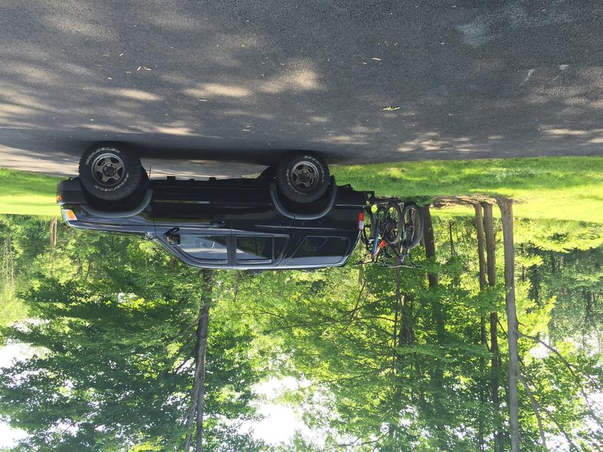

I run stock bumpers and overall weight. Second clip from bottom again with tundra cold and on tundra 5100 shocks.
This is with two Bicycles and rack not a real amount of weight. It's perfect. I think with the lower coils in rear it won't be level but down in rear. Just my opinion
I don't know why all my pictures load upside down. Sorry!

Well, if that's the case, you have a couple options. Either get adjustable shocks/coilovers for the front, or get some OME 906 springs. 890's in the back with your front setup will have al least an 1" of rake, closer to 1.25" The 906s do have a higher spring rate, which will keep the rear from sagging if you load it up a bit.

ahhh I thought you had or was going for same setup I had. In which case I vote keep rear down a little more than 890's you would be better off with 906 my vote.
Agree. 906 will be answer. In future or if you end up thinking its to level or low for your liking throw a small shim spacer.
