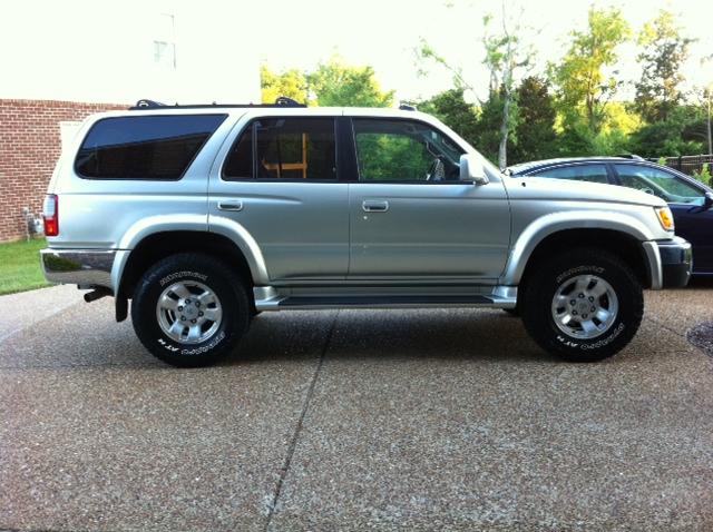

Not sure about the weight difference between 4cyl and 6cyl, but I did it on my 2wd (lots of others have, too) and think it looks great. I did both front and rear, with '99 coils. It gave me about 2 inches, which was perfect. When I first put them on I thought it was more than I wanted, but it settled just a bit and is perfect for me.

Nash: Thank you, thats just what I was looking for, but wow the rear is actually taller then the front? thats unsual, even on my 4wd the front was taller then the back, anyway, I have from 01 springs with 40k that I will be putting on a friends 2wd runner, I installed the rears today and it looks like it went up about 2 inches already, lets just hope the fronts dont end up higher then the rear looking too raked haha. Thanks

I think that's a bit of a camera trick. The back might be just a tad higher, but not much at all. It's pretty even. I can measure tomorrow if you want. I don't have the rubber cones in the back coils, otherwise it would add another half inch or so.

Meh, I measured anyway, because around here we like to measure things. These are from a concrete floor straight up through the center cap to the bottom of the arch of the fender:
FR: 36.5"
FL: 36.5"
RR: 37.25"
RL: 37.25"
So yeah, the back is a tad higher than the front, but not much. If I put the cones in the back it'd be about full inch to inch and a quarter difference.
