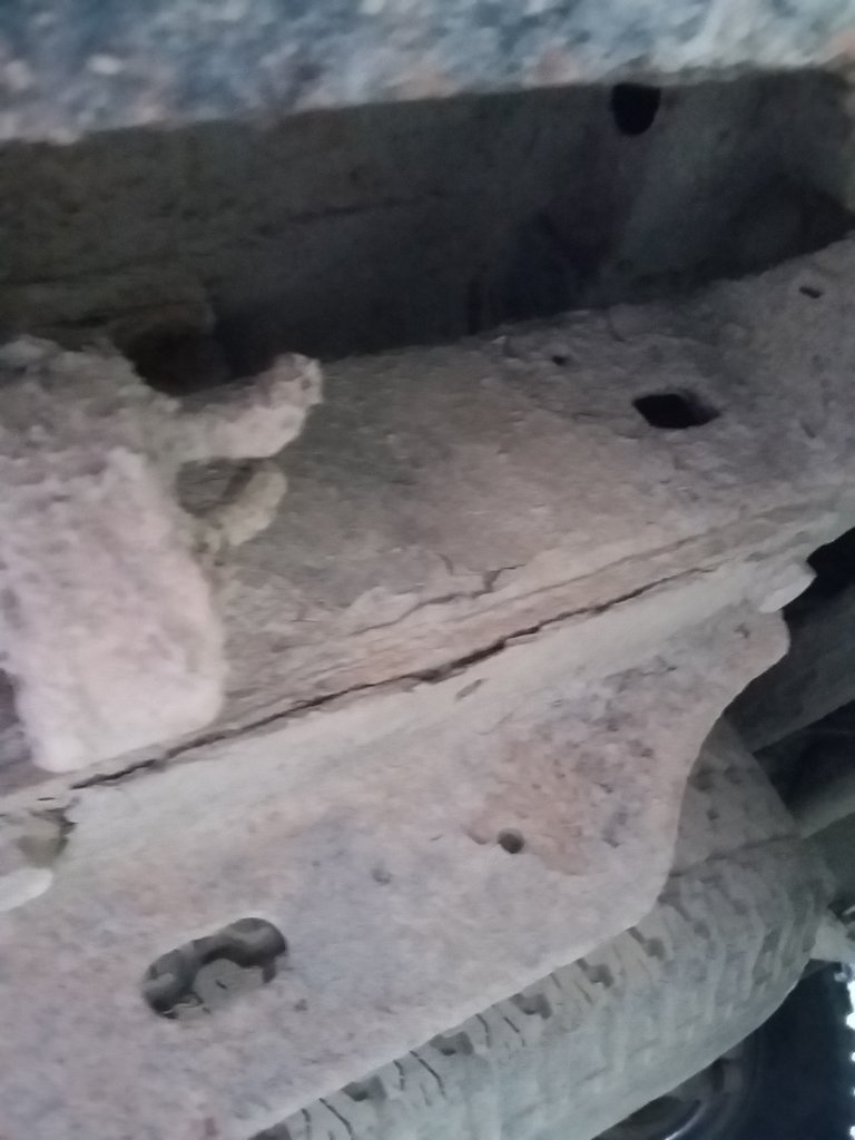

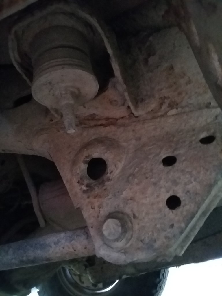

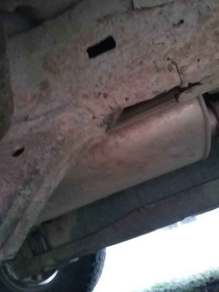

The title pretty much says it all.. I need some advice. Would you guys risk buying a 3rd Gen knowing full well that the frame needs plating? The guy sent me these pictures today:
From what I can tell its fixable.. but will it be safe? Does anybody have experience with this kind of repair? The only thing that's making me even consider this deal is the price.. which is very, very fair.

If it's at the right price, why not? Under $1000 is my rule. Assuming the rest of it is good and you have a good welding hookup, you should be golden.
Don't even bother asking this to someone living where it doesn't snow.
A few years ago My dad and I built a whole new frame from the axle back on my 87 wrangler. It's held up good so far. For the past month I've been working on my 99 that had a hole in the same location as yours. It turned out to be way worse than I thought it was and I've had to custom bend a section that goes over the hump in the rear just after the LCA mount and it goes all the way up to a crossmember (about 2 feet long). I've built a box around the bad stuff and have welded it to good metal on the original frame. We'll see how well it turns out cuz I'm not completely done yet.

Still negotiating with the guy, but I'm willing to bet I could get it for around $500.. This is why its tempting as hell

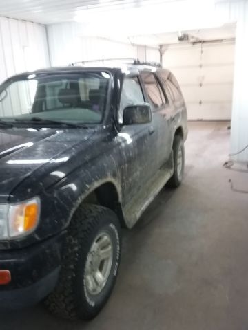

We need to see the rest of the truck. If you have a garage & welding equipment. $500 might be the trucks worth.

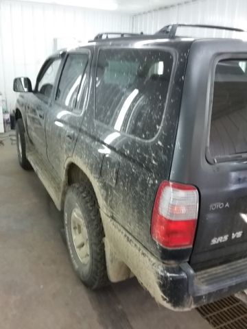

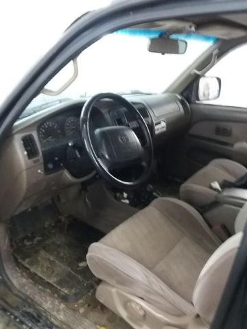

These are right from the guys Ad.. I don't have much for work space (actually, hang on, I have no work space), but I do know a competent, experience welder who happens to owe me $400 worth of work.

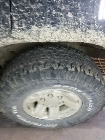

I'm sorry, the guy's an idiot. Who try's to sell a vehicle with dirty pics??? LMAO! The decision is up to you.
I should've taken pics of my 99 when I bought it. It was so dirty inside and out. The guy I bought it from said he could get it detailed before I picked it up but I told him don't bother I need something to do this weekend.
Rockers and rear wheel wells solid? Go for it. Winshield frame and bottom tailgate edge are typical but not as urgent areas. I'm guessing this truck is still being dailyed. No big deal for me until I see the truck in person.
