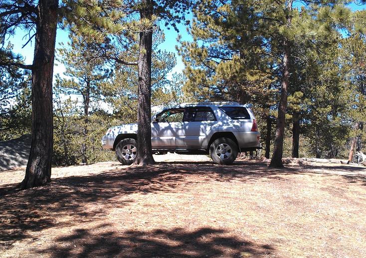

Thats good info on the GY SAs, those were another choice on the list. Got any pics of those on your 03?
This is not the best pic to show the tires but I dont have a lot of pics.
I can tell you that the Silent Armors have performed well in snow and ice, they are quiet and they did not kill my gas milage like the Duratrac did.

Thanks for the pic. They look pretty meaty. Does anyone offer the 275/70/17 in a prograde? Or is it just the regular for that size?
