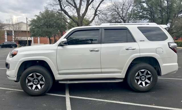

Yes, I did it and it looks great.
Well, if you’re a 4th gen, which I thought this thread was in, and your xreas is 10+ years old I’d still say replace. It is possible. ⬆️
