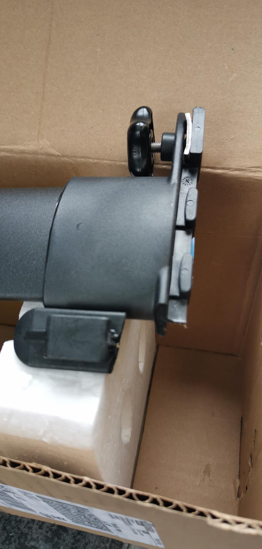

Looks like the rails came broken in a box, gonna get another set tomorrow. Anybody have these break while on the roof ?

Looks like the rails came broken in a box, gonna get qnother set tomorrow. Anybody have these break whioe on the roof ?

I'd ordered a set of stock crossbars and they showed up broken. Not that badly, but broken. Unless they're severely overloaded, they shouldn't break while installed.

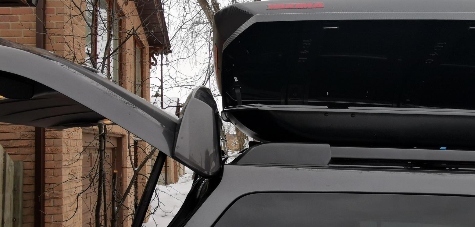

With the 18 you also won't be able to open your liftgate fully with the box installed, just so you're not ripping your hair out trying to figure it out...

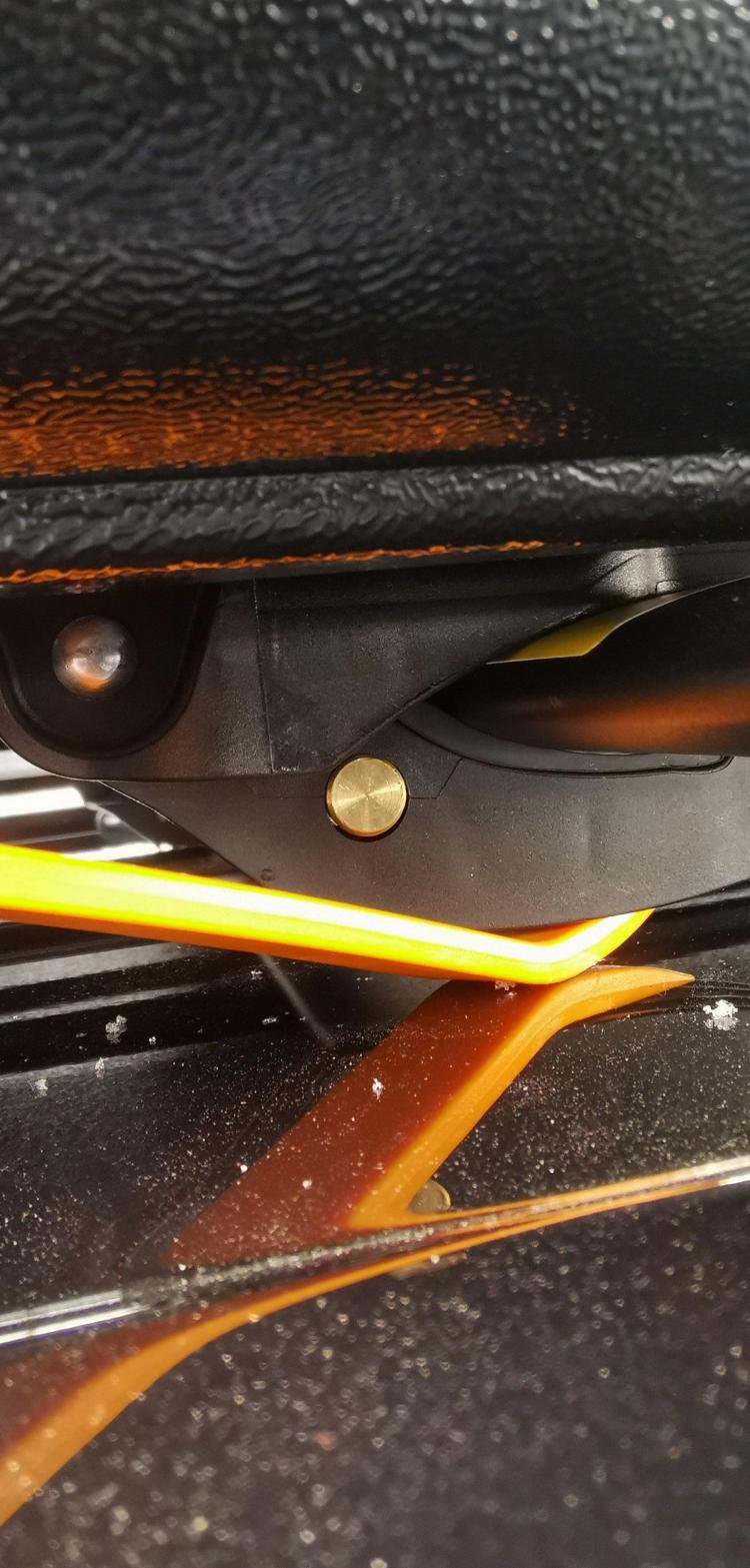

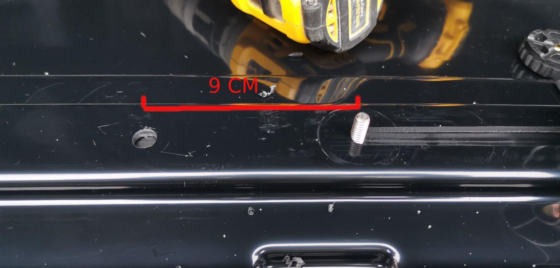

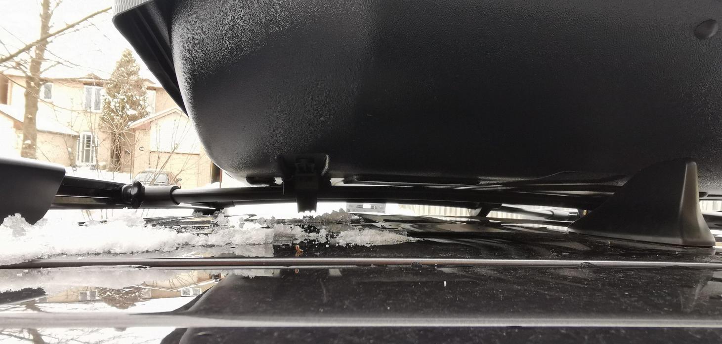

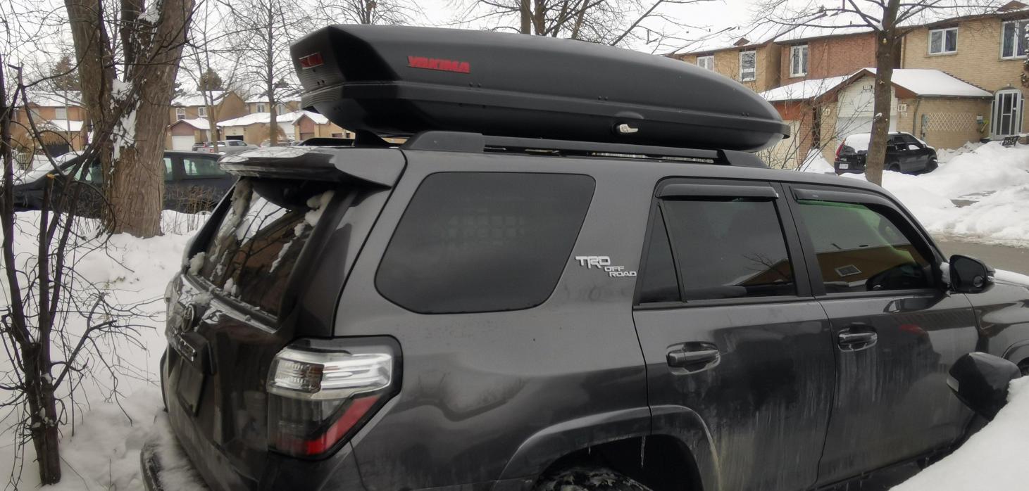

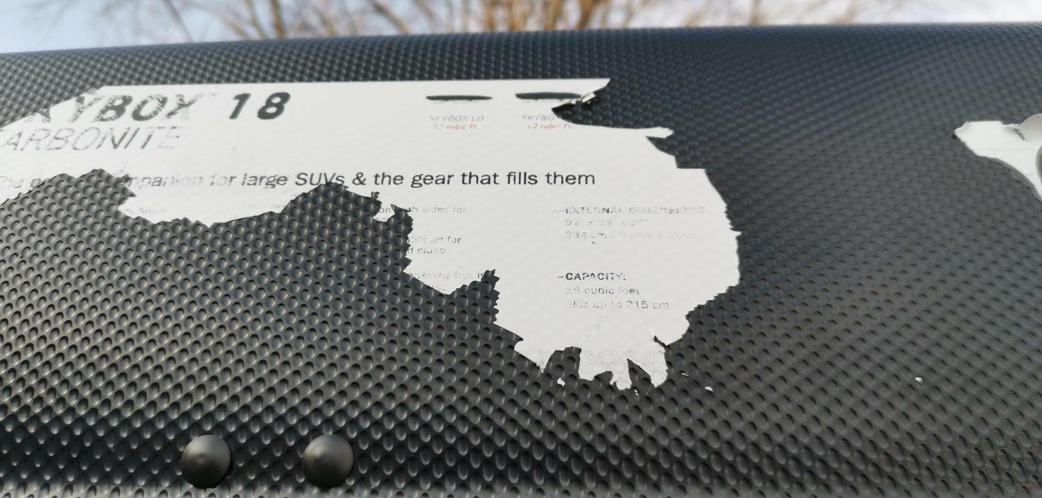

Finished the installation today, it was really easy and only took about 20 minutes. After that i spent another 30 minutes peeing off the sticker. Yakima if you are out there, please make better peeling off stickers.
I had to make one small modification - drill 2 holes (1 each side) to allow the front clips to move back by 9cm. Make sure to only drill through the first layer of plastic, second layer is sliding mechanism (as per picture).
When installed there is about 5mm space between the clips and the roof, when applying some force from the top it doesn't look like it will be touching the roof when driving as the toyota crossbars dont flex that much, however as a precaution to avoid scratching the roof i will be putting some thick transparent anti slip pvc tape under those spots.

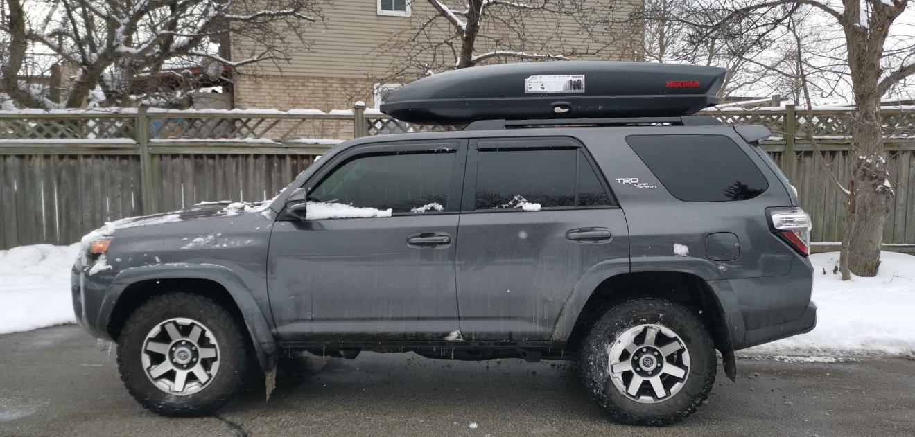

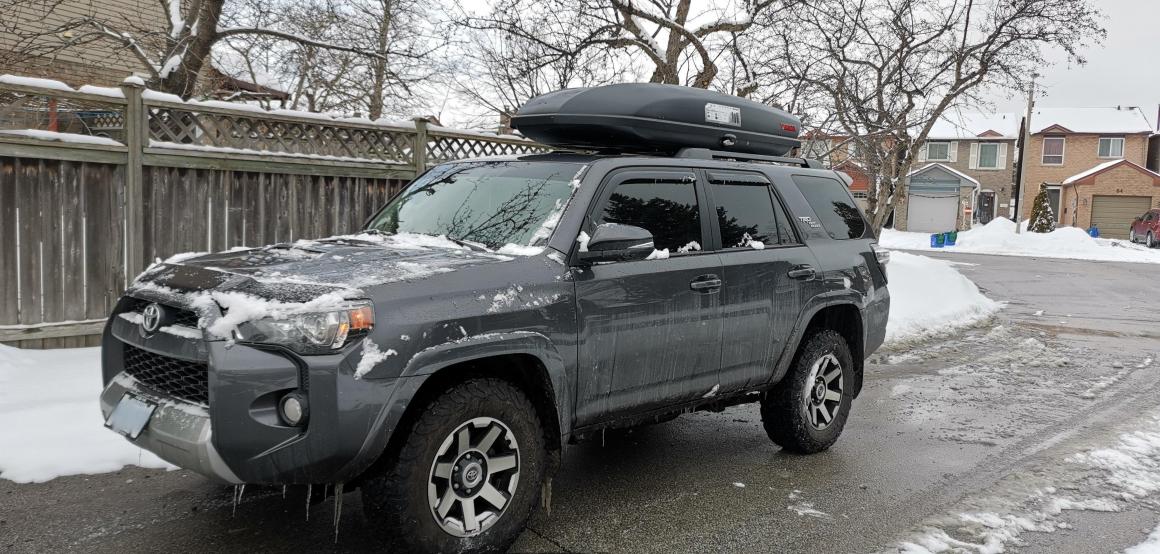

So to summerize, it is possible to install Yakima skybox carbonite 18 on a 2019 4runner trd offroad using stock toyota cross bars. Trunk opens up fully and there are no issues with touching. But as precaution i would suggest putting some tape to protect your paint if it doesn't manager to touch.
As others suggested, put a towel on the roof when installing the box as you may scratch it while aligning the box on the roof.
Sat/nav antenna doesn't touch the box either, lots of space.

So to summerize, it is possible to install Yakima skybox carbonite 18 on a 2019 4runner trd offroad using stock toyota cross bars. Trunk opens up fully and there are no issues with touching. .
My Carbonite Lo shakes like crazy with that front mount all the way back, especially unloaded. I can't imagine how much more that will shake with that mounting point another 4" back.
Maybe im lucky, but i just went for a quick drive, only went as fast as 90km/h and so far so good, no noticeble noise or vibration.
If i shake rhe front up and down by hand, it does wobble, i think im gonna run a strap from the front down to the cross bars to pull it down a bit just in case.
Ah ha! This drill approach might solve my lift gate issue. Thanks!
Second the factory bars. It fits just fine. The clearance is small, but adequate under the front clips. Rear hatch opens. No issues with the satellite antenna or reception.
