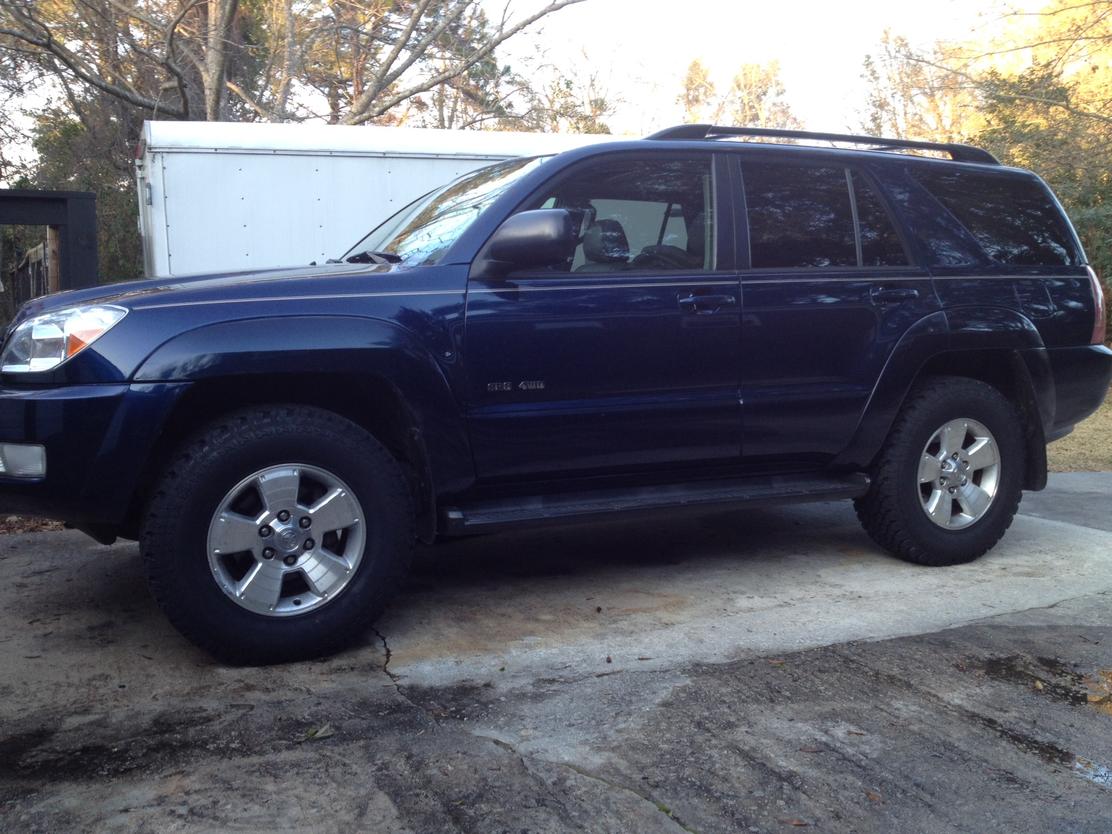

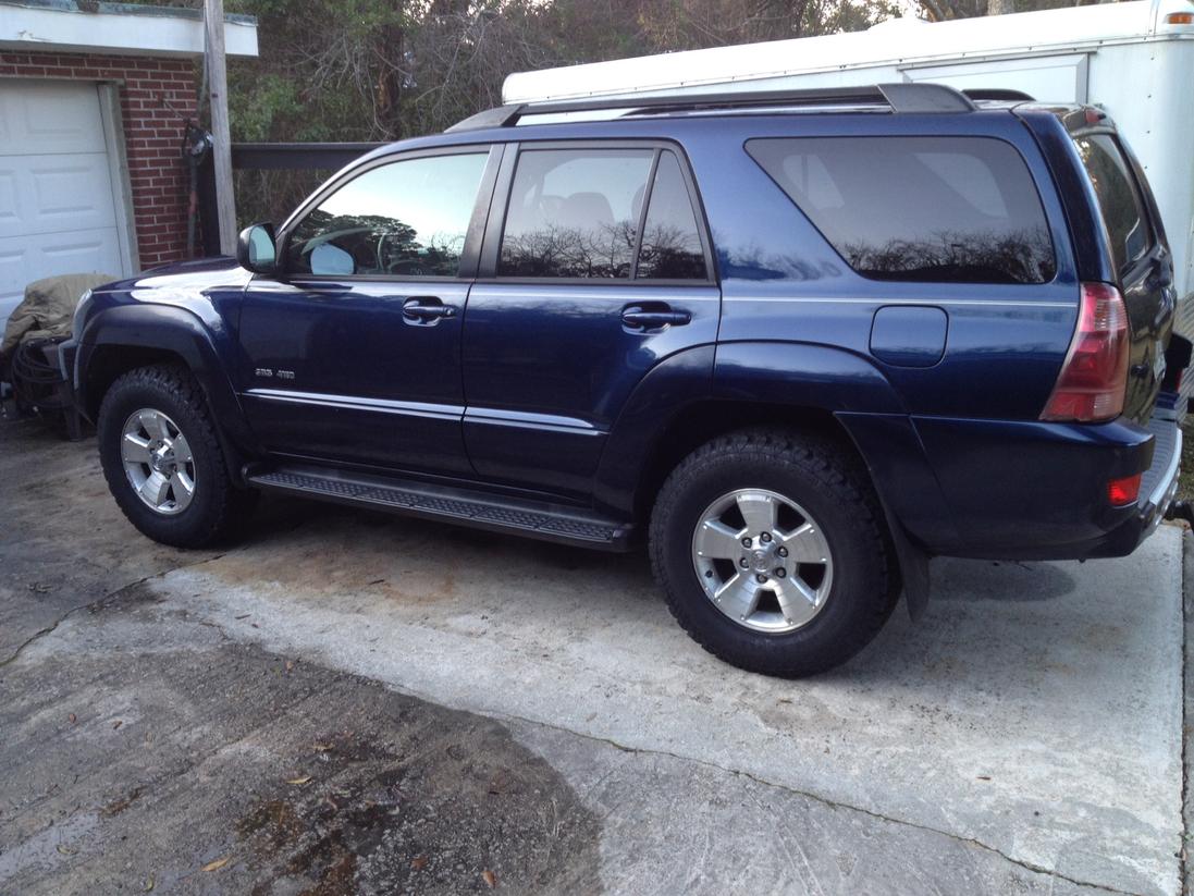

Got 'er done.
Grabbers 265/70/17's and a Daystar Budget 1" boost. Tires just barely fit, width wise.
Looks like the boost gave me a couple inches and I'm within 1/2" from level. Much better!!

What year 4runner do you have, and are you able to use any FJ springs in general? Ive got daystar 2.5/1.5 level now, wouldn't mind better ride quality if I can do it on a budget.
Rig looks real nice Stono!
