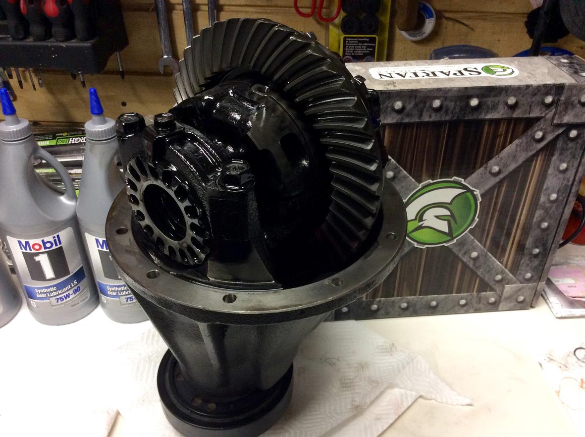

Yeah I installed it Wednesday evening on Nov.17th I started at 6pm and finished completely at 1am. At 5am got up drove my chick to work in it as I pulled out of the garage I was nervous with every thought going through my mind and hoping I did it right.
Well let me just say since that moment I havent had one issue what so ever and the Spartan Locker handles like a dream. Ive still not heard this BANG sound and can barely hear the clicking when turning. After all the horror stories I read about all the crazy sounds and lockers annoying characteristics I was positive that soon down the road I was gonna be ripping the locker out, well I only see that happening the day Im replacing it with a new one.
So I drove her to work then myself to work and both of us back home in it totaling 30 miles or so, and pparked it back in the garage and loaded her down for our 3 day Death Valley Run starting the next morning on Fri Nov 19 drove 300 miles to DV then another 50 miles to 1st destination of the trip Goler Wash (most difficult trail in DV) at this moment, proper break in period on the new Spartan Locker? probably not recommended but This is what I came for and why I installed it so lets see what it's limits are!!!
Still to this day I haven't found that yet...she just hammers right on through I had a perma grin and full wood the entire trip.
For all the people who said dont do it, you'll waste your money, get an e-locker hold out, its not gonna handle right....ALL WRONG.
Even my chick loves it and doesn't even realize it's there and this being her DD for everything...what more can I say.
I hope this helps anyone trying to decide or looking for positive info.

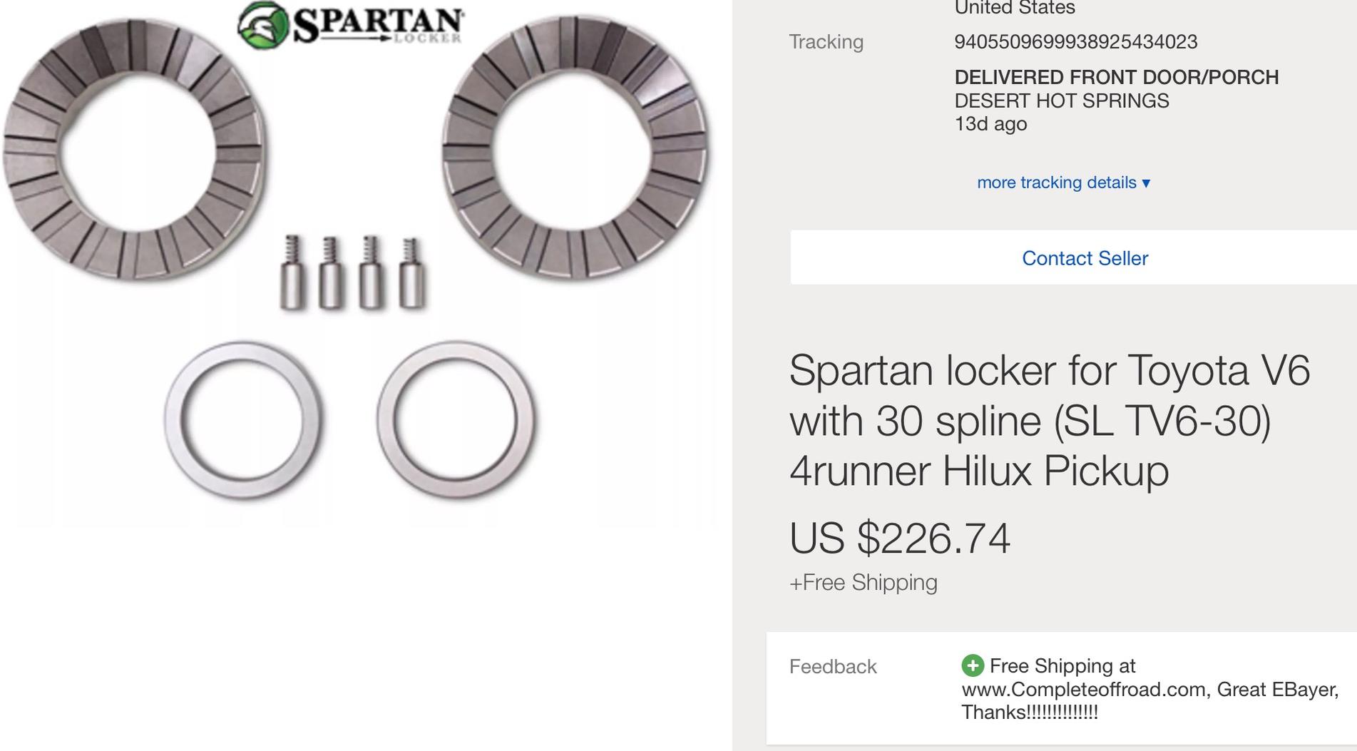

Well [MENTION=49649]KidVermicious[/MENTION] pretty much summed it up, I wasn't in any position to get a project like that done financially and nor had the time. I had my front end completely torn apart rebuilding it and the rear end torn apart to install the locker and of course while I'm in there might as well replace the seals and o-rings inspecdt the axles etc.
I just knew it wasn't gonna be feasible with all the projects I wanted to get done and it was gonna be my first time opening up a rear end on a vehicle so this would allow me to take a baby step and learn hands on to get a complte understanding of how all the components work and what it really takes to get future projects like this done now that I have broken the ice with my fear of dismantling my rear end, sounds so wrong I know.
After all my research and searching I almost got the LockRite Locker which is made by Aussie Lockers which they renamed and revamped their locker after getting a bad wrap here in the U.S. back in the day but the neg reviews out weighed pos barely I think only because of the past product still haunts them.
The Powertrac Locker faired slightly less compared to the LockRite.
The Detroit is the Detroit not much has changed, the Grizzly and the Aussie seem to be better options with less noice and stronger steal pin.
As for the Spartan what lil info is out there and lil known about it the pos weighed out the neg also being made by Yukon a company known for making good products that stand behind them and there warranties put me at ease. But what sealed the deal was KidVermicious giving it to me straight with his hands on experience of owning/installing the Spartan and from a couple vids i seen it seemed to do what it was supposed to do with only having to install a couple compenants, remove a couple thrust washers and correctly slap it all back together and add fluid.
Purchased it from CompleteOffRoad.com through Ebay since it was cheaper than there website priced at 249-269 it varied if they were having a sale or 10% off.
But through there Ebay store it was only (see below)....go figure as it made my decision simple and they said they would have it to me the date I needed and nobody else would guarantee me that. they also gave me a 25% off voucher for a 1 time any item they sell ....I see my gears coming now.
