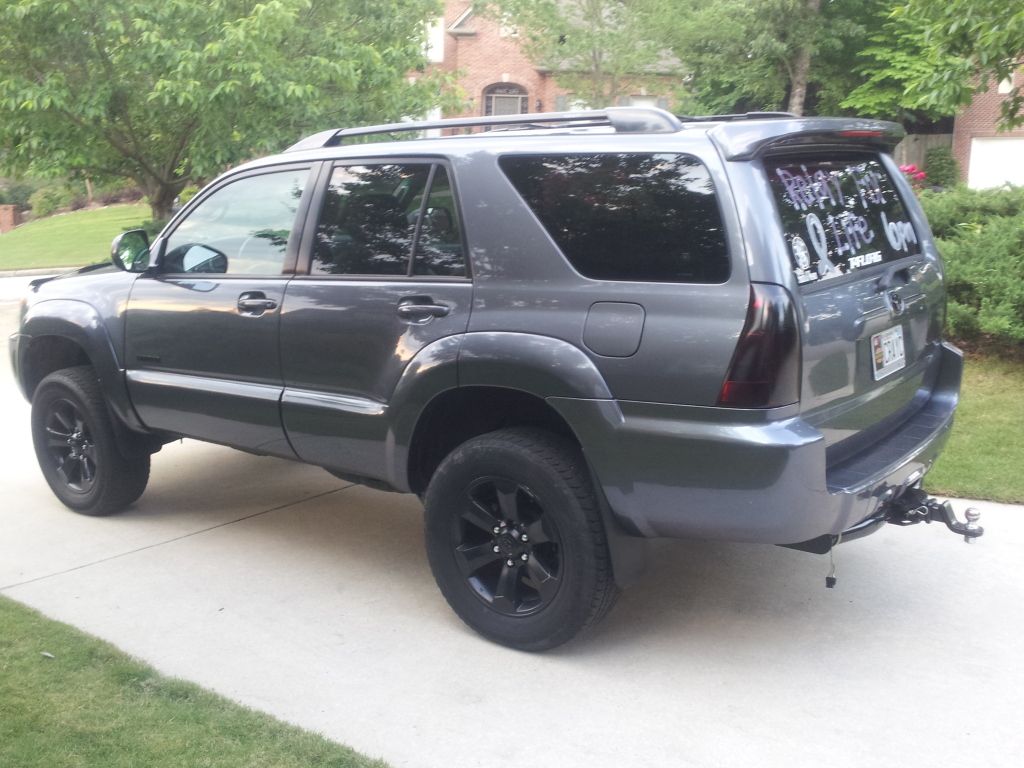

I finally gave in to my want to black it out, so started with the taillights! VHT Niteshade spray works great, just use some fine sand paper to WET sand the lights, and then apply however dark of layers you want until you get the right color for you!
And so next came the wheels and AVS BugShield in the blacking process! I considered several aftermarket wheels, but really came down to liking my stockers better than the ones I was looking at ordering! Got them painted (not powder coated, which is more durable). Mine still look great, no real wear to them at all, and love the wheel!

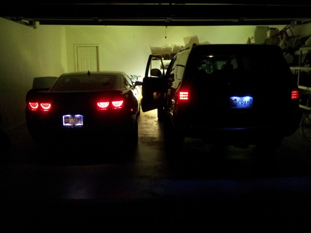

Next came the new DDM Tuning 3000K HID Fog lights, as well as the license plate lights! Love the cool white color with its slight bluish tint, really accents white license plate as well as body color
License Plate lights
Full array of Lights Comparison...
3000K DDM's after 2 seconds of warming up.
Fully warmed 3000K DDM's

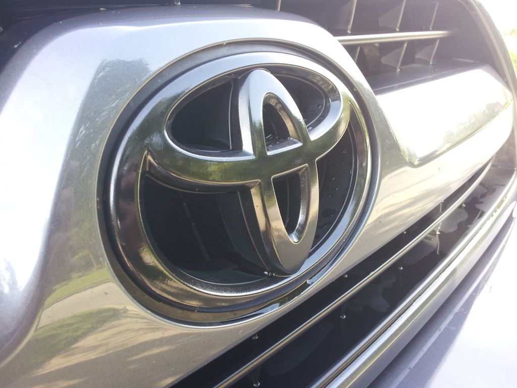

Blacked out the Limited and Toyota emblems one afternoon with Krylon exterior enamel rattle can after my buddy with the camaro above convinced me in 12 seconds that it needed it haha...

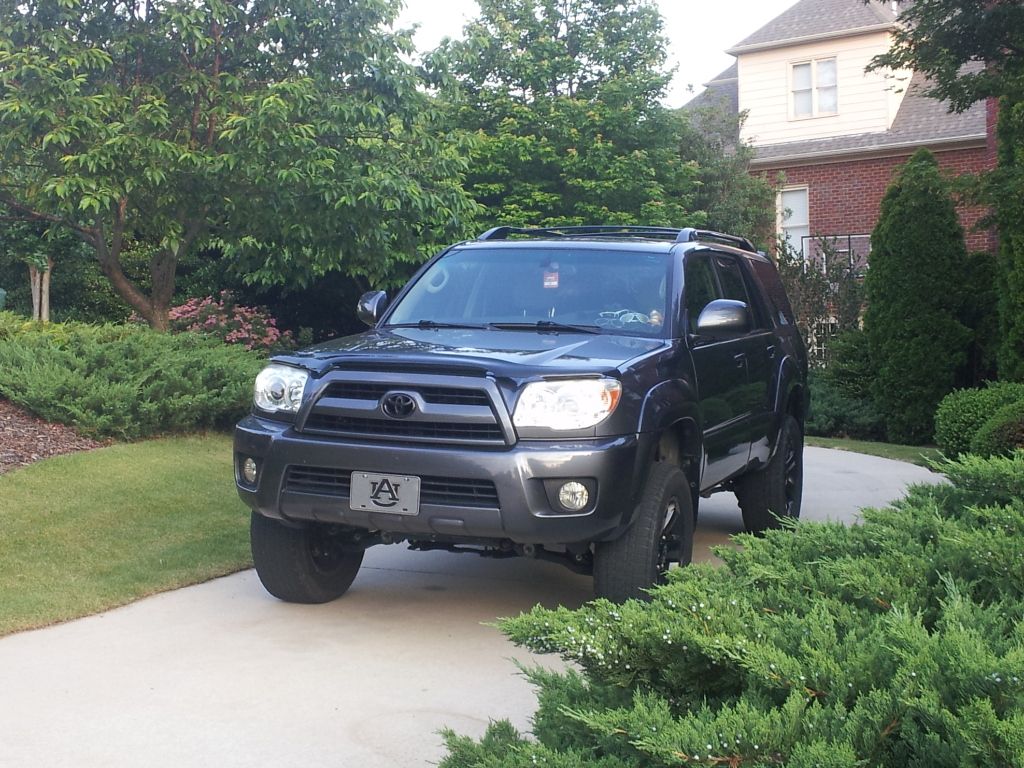

The Lift came next, as my Firestone's had finally worn out after 58 thousand miles (great tire, highly recommend to anyone looking for a great road tire) so I was due for an upgrade!
One last shot before putting it up on the jacks!

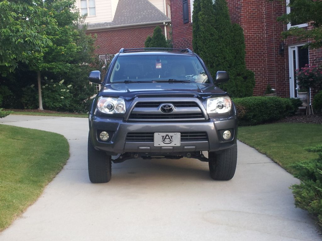

Installed Daystar and FJ Coils, didn't measure stock heights, but ended up at 39" front and 40" back, measured to middle of fender wells, AFTER tires. Slight change in ride, stiffened up a little, most likely due to FJ coils. Other than that she still rides like stock, minus a bit of pep due to tire rotational weight.
Install was a definite PIA due to multiple bottle jack failures trying to reinstall struts... Back literally took 20 minutes, half because we replaced the end link bushings, and that takes a little elbow grease because the bolts sit at an awkward angle.
Overall so happy with the stance, and now after moving fender liner forward, right tire only rubs the bumper at one tiny spot when it hits just the right awkward angle...

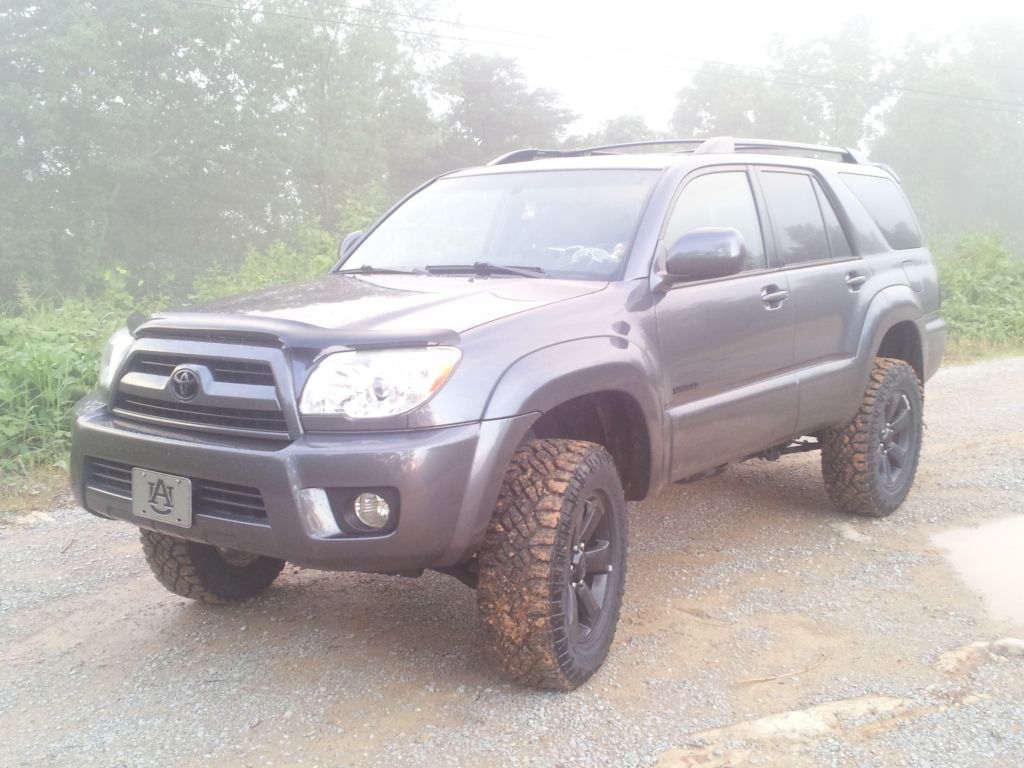

BEFORE new tires.
AFTER, with 275/65/18 Goodyear Duratracs
