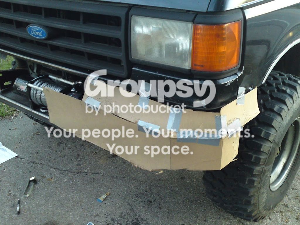

Ford guys swear by cardboard. Just don't drive in the rain...or hit anything, an you should be good they say.

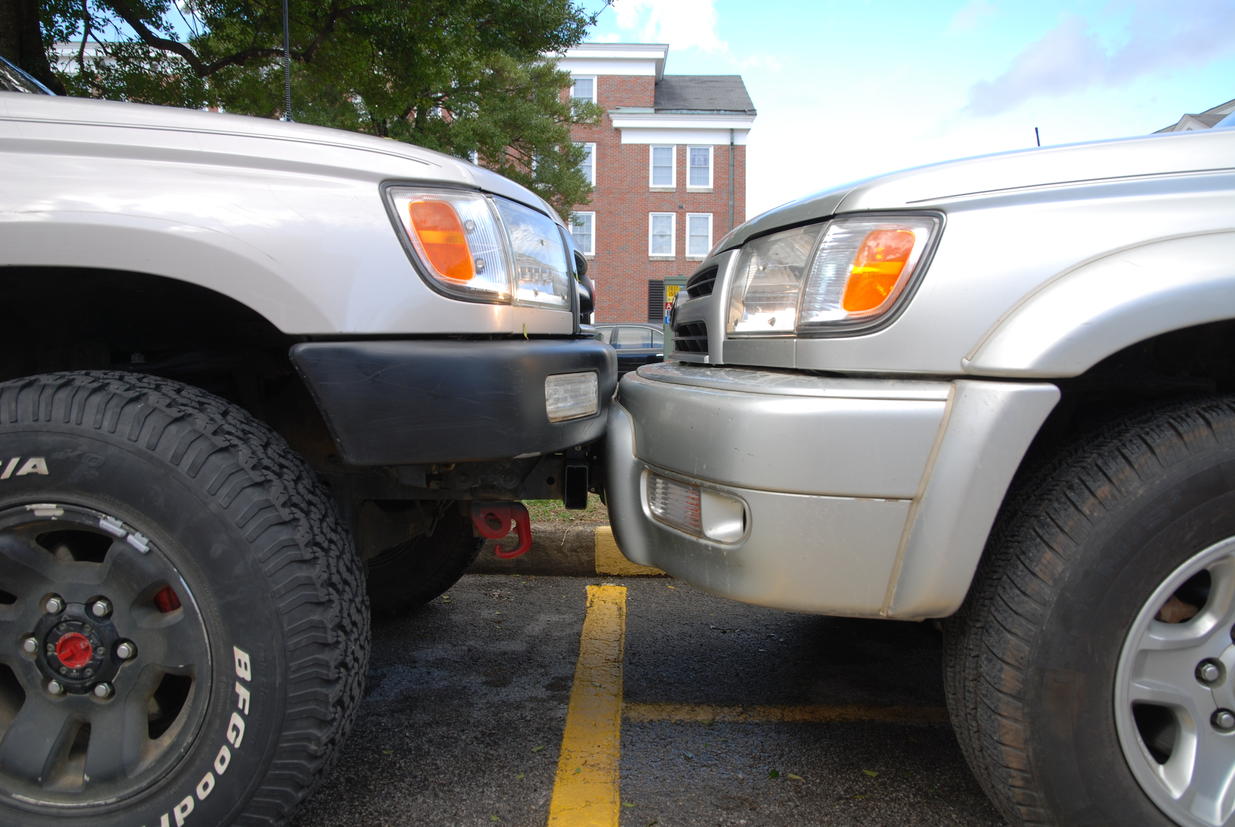

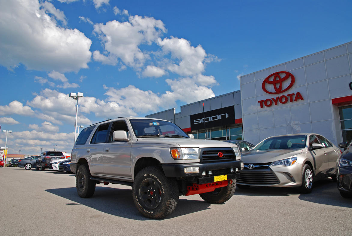

You can make the 96-98 bumper approach angle even better with the plastic off.
I added a piece of 3"x1.5" rectangular steel to mount my lights. It saved my radiator on one occasion :0
EDIT:
Here's a comparison between the two. Mine on the left has 99 springs and 32" tires. The right one has 2000 springs and 31" tires
You can take that bottom "fat lip" off of the 2000 also and have the same look you have. Only problem is no more turn signals. Unless you mount them under there somehow or wire them to your corner markers. Someone on here did it. But I forgot who

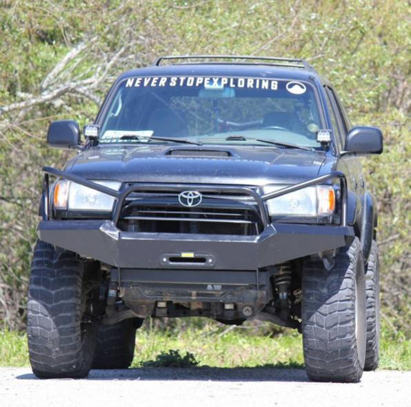

Just a side note, but I personally wouldn't use the ARB as the benchmark. I made my own "budget" bumper to replace the ARB I already had. The ARB destroys your approach angle and will flex into the body if you actually hit it.
Custom > ARB any day
I like the idea of the front hitch for a portable winch mount... but that hitch looks like it protrudes way into the angle of approach and is just begging to catch on berms/rocks/roots/civics/etc.
I know, i did yhe receiver before the bumper and it does stick out WAY TOO far lol. I'm going to cut it down so i can just get to the pin hole.
Lol i also love the "Happy to meet you"

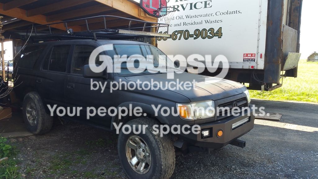

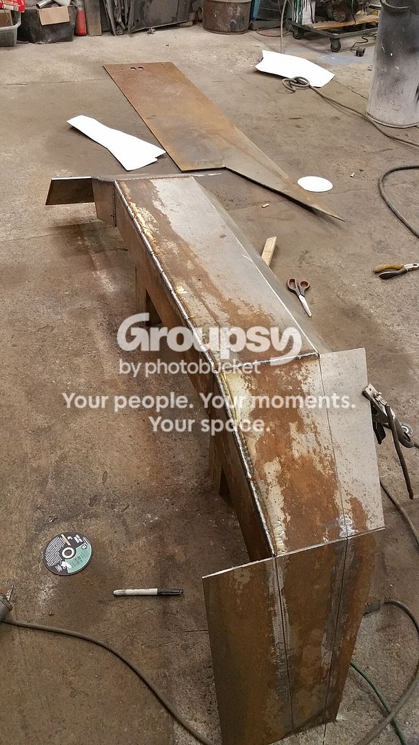

I built my bumper for 180$, plus the cost of the winch. I did all my own welding and plate cutting. Steel was sourced locally at normal retail cost. It's still incomplete in this picture.
