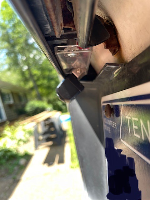

I used a camera mount from Amazon that replaces one of your license plate light lenses. It's intended for a 4th gen I believe, but I went to Ace Hardware and bought a couple bushings to lower the lens down even with the other stock lens. Hardest part was running the wiring into the rear hatch, through that big rubber grommet. Best thing you can do is attach your wiring to a metal coat hanger and spray it down real good with silicone spray (I used the liquid wrench brand).
Here is the camera mount I used from Amazon:
8 LED Adjustable Angle Car Rear View Camera for Toyota 4Runner/Hilux Surf 2002~2010
I did not use the camera that came with the kit, but bought a better camera instead:
HD Backup Camera,Metal Housing 170 Degree Wide View Angle
If you look at the picture below, look at the screw head, then look directly above it. You'll see the stainless bushings I used to drop the lens down.
