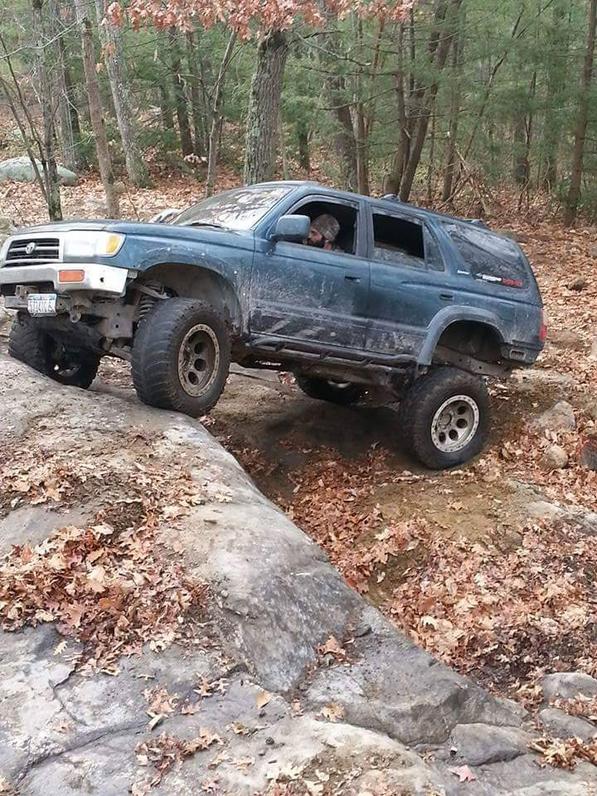

You can make the 96-98 bumper approach angle even better with the plastic off.
I added a piece of 3"x1.5" rectangular steel to mount my lights. It saved my radiator on one occasion :0
EDIT:
Here's a comparison between the two. Mine on the left has 99 springs and 32" tires. The right one has 2000 springs and 31" tires
How do you take the plastic off? Is it just a few bolts?

I've seen a stock rear hitch cut down and welded in-between the frame rails. The steel like mine has is held on by 2 10mm bolts so it isn't very strong
Not a good angle, but hopefully it helps a little
