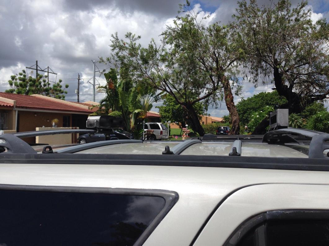

Picture of current set up. Thanks a million GVL!! I'll ask the seller now

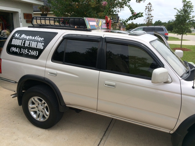

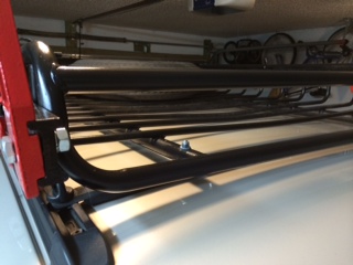

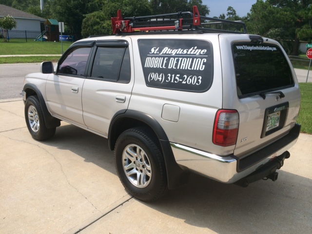

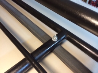

I did something different and put bolts through the smaller crossbars for my Yakima Load Warrior. I was a bit apprehensive to do it this way until I put it all together and grabbed it and pushed and pulled as HARD as I could (I am 235 and 6'2"). Didn't budge. Now 2000 miles later and a Hi lift jack for my trailer mounted to the side and my trailer spare tire mounted inside its still perfect. It makes it sit as close to my roof as possible which was my goal. I made some L shaped brackets that clamp to the rack and bolt down into the OEM rack rails for the jack just recently and its holding fine too.
