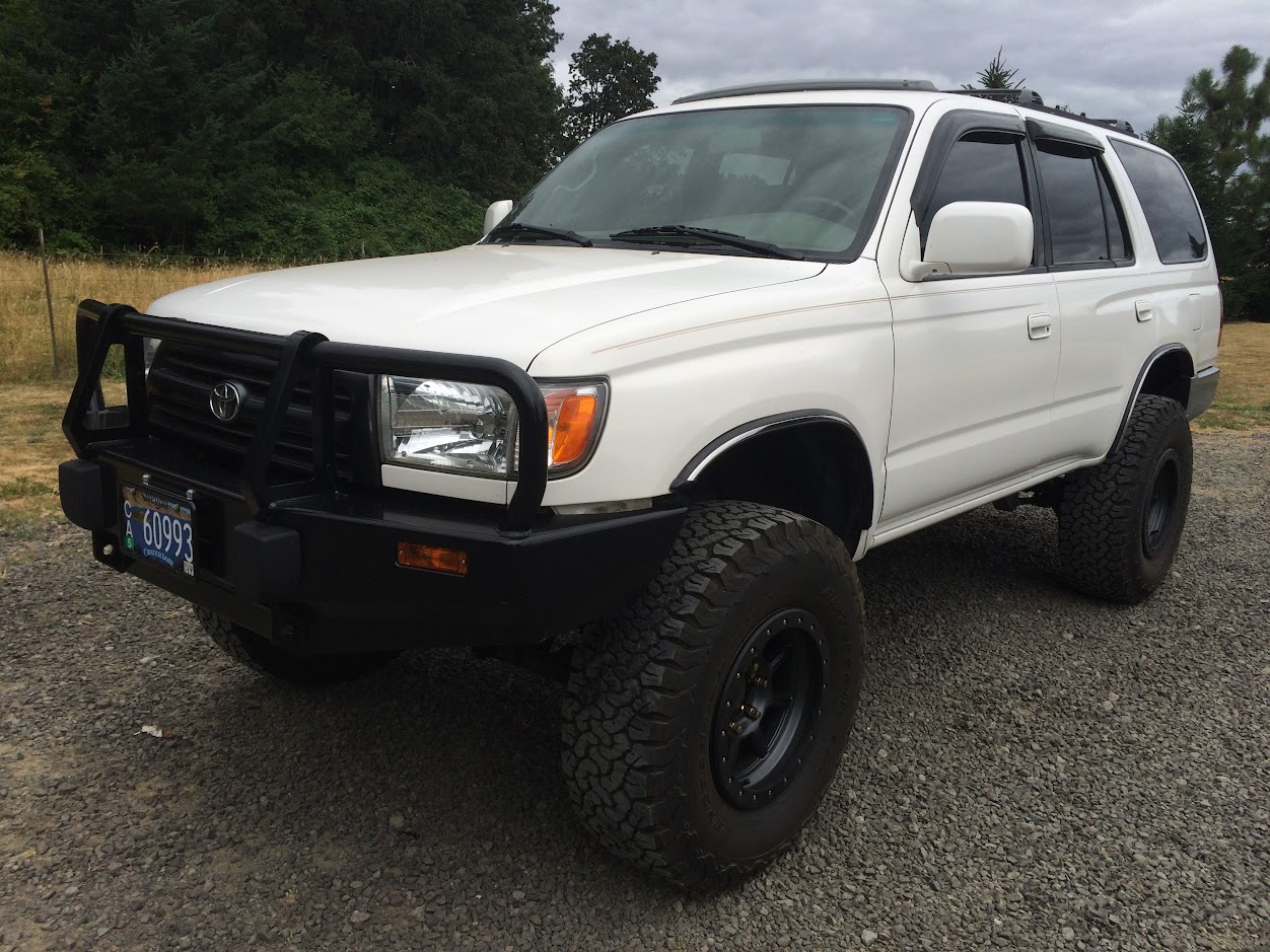

ARB Bumper install time:
Cut the ends of the frame off.
Got the brackets mounted.
backside of bumper.
And mounted.
The install went better than I thought it would. I was going to just cut the flange off of the frame head and leave the end closed but it was so much easier to just cut the whole end off. I will plate it later when I take bumper back off to install winch.
As a note... the ARB instructions are horrible!!!! They are actually pointless and didnt even get used. I have a bag full of unused hardware with no clue what they go to but the bumper is mounted completely and solid. I love the look of the bumper. My brother helped out which is a must for final mounting of the bumper.. just went so much easier. After it was installed he ordered one for his FJ60.. such a cool product

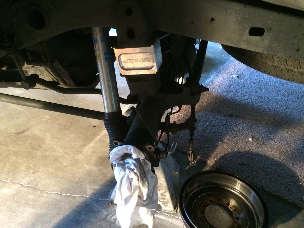

Got my axle seals, rear wheel bearings and brakes all replaced this weekend.
Tire tracks!
Original bearing on leaking side.
Passenger side had already been replaced at some time but I already bought the parts and didnt know when it was replaced so just did them both for peace of mind.
Brakes were gear oil soaked.
Back from the machine shop all clean and ready to go. Using autozone brake shoes and if they start squeaking I will get some toyota shoes.
All back together and so fresh and so clean
Pretty easy and straight forward job

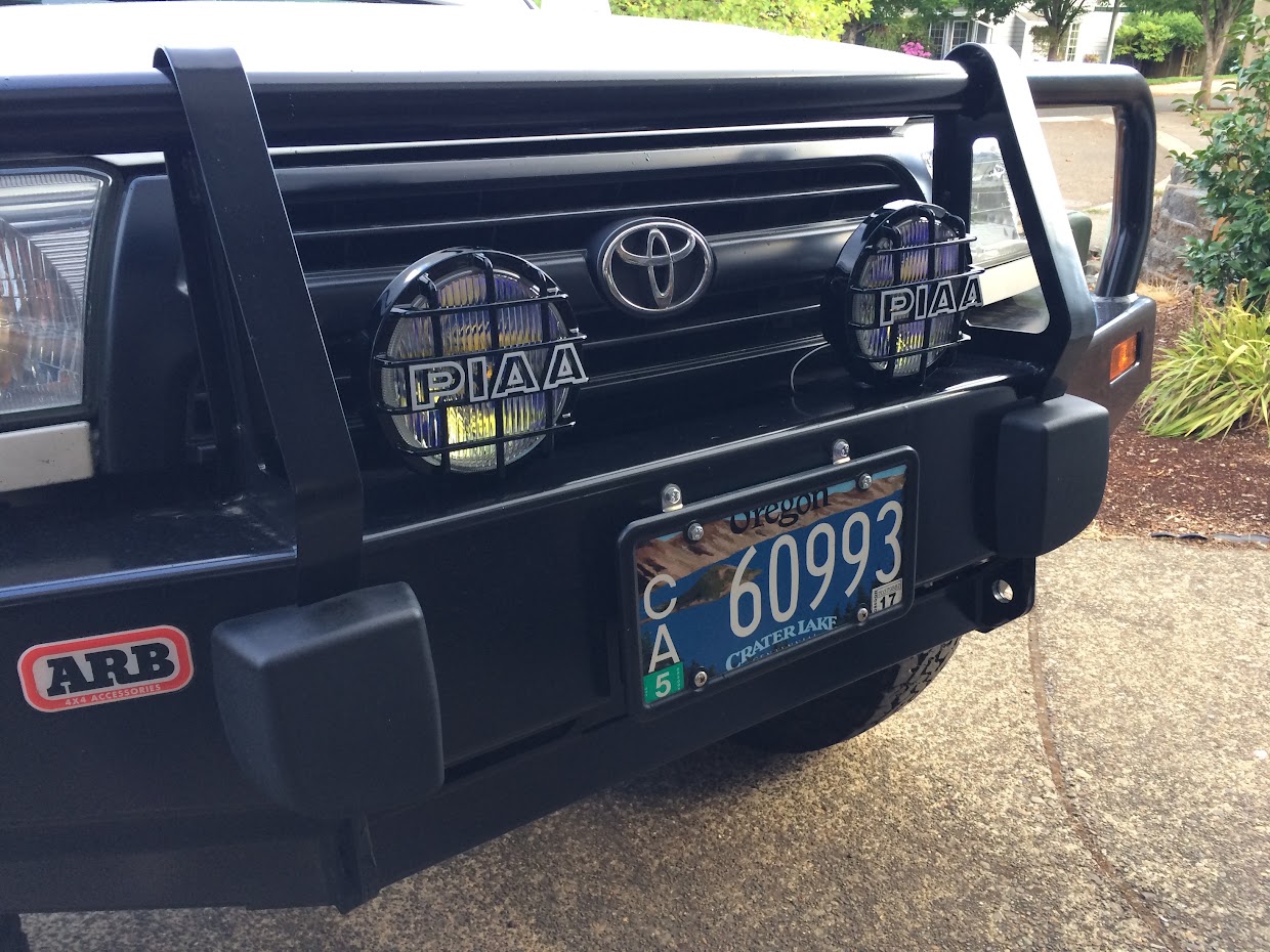

Wired in my PIAA fog lights this weekend.
Used an open bank on fuse panel...
Where I mounted relay using a factory tapped hole..
The cut off the PIAA switch and went with a factory toyota switch instead. Looks bare over here but soon there will be ARB locker switches and winch control switch to fill in all the holes.
Then added a grab handle...
AND.... my savage offroad sliders arrived
