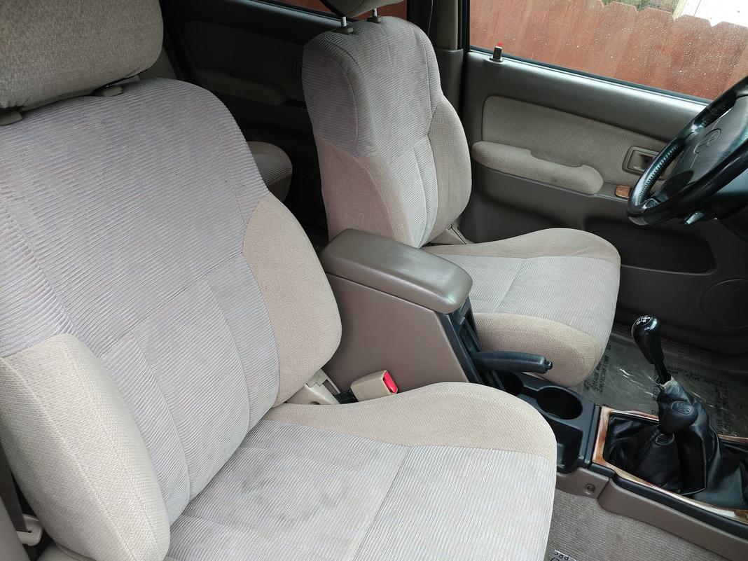

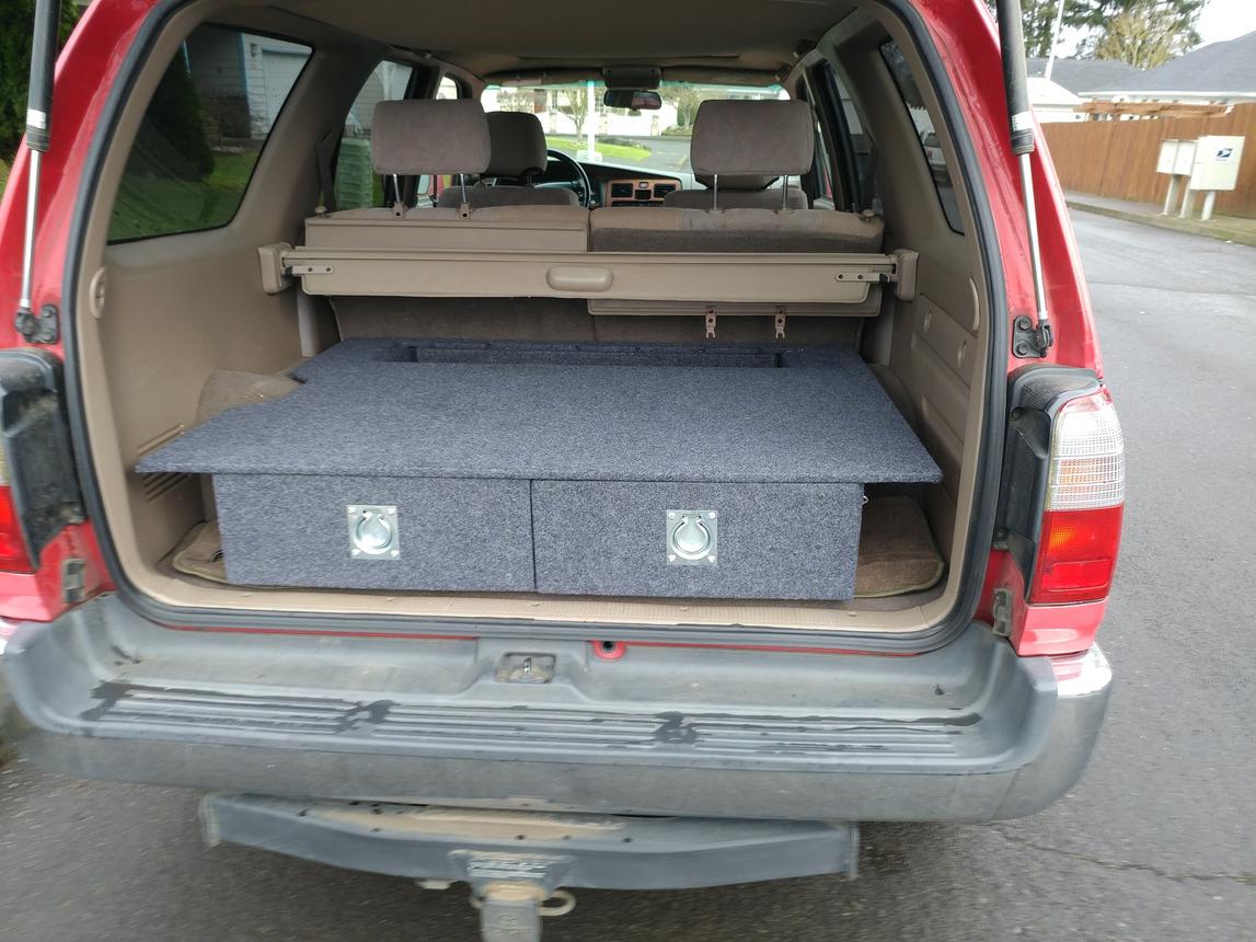

The first thing done was putting my platform back in.I had previously build a platform for my old 4runner to sleep in and no one who was willing to pay for it was close enough to pick it up so it just sat in my fathers garage for a year until I got a new one. Was very nice to have back in. Felt like home.

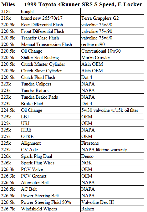

Here's the maintenance that I've done since I've owned it. I now trust it to drive across the country.

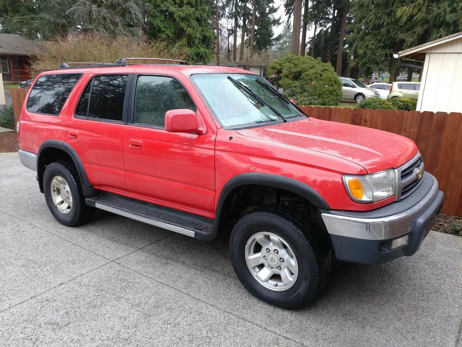

First thing I did was replace the wheels and tires, they were pretty shot. I got some 5th gen wheels with no tires and found some 265/70r17 nitto terra grappler g2, brand new for $400! The stickers were still on them. That was a score, the dude said he had dozens of people calling after I called.
You can see in the first picture that the sag on the 4runner was pretty bad. Instead of opting for a lift or stock replacement I decided to add a 1.5" daystar spacer until I decide to lift it.

Some obligatory maintenance pictures. I've done a lot more, these are just the recent ones that I've done. I'll add my excel file sheet up top so everyone can keep up with the maintenance that I've done. Also bedlined the grill and painted with the Napa paint match of my radiant red, I really like it.
