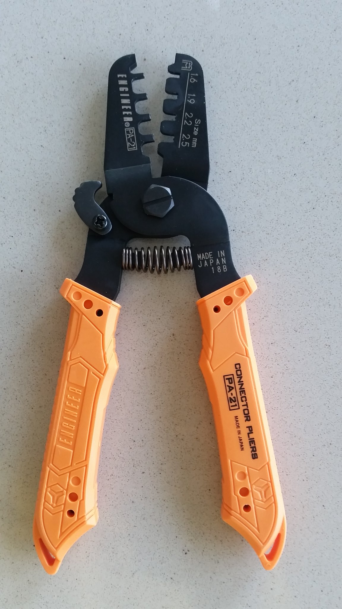

So I tried a few different crimpers over the last few days, and settled on the most expensive one, naturally. "Engineer" brand, direct from Japan:

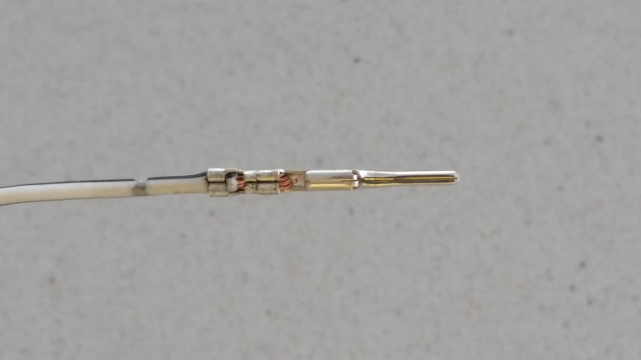

Here's the first crimp I made, sweet:

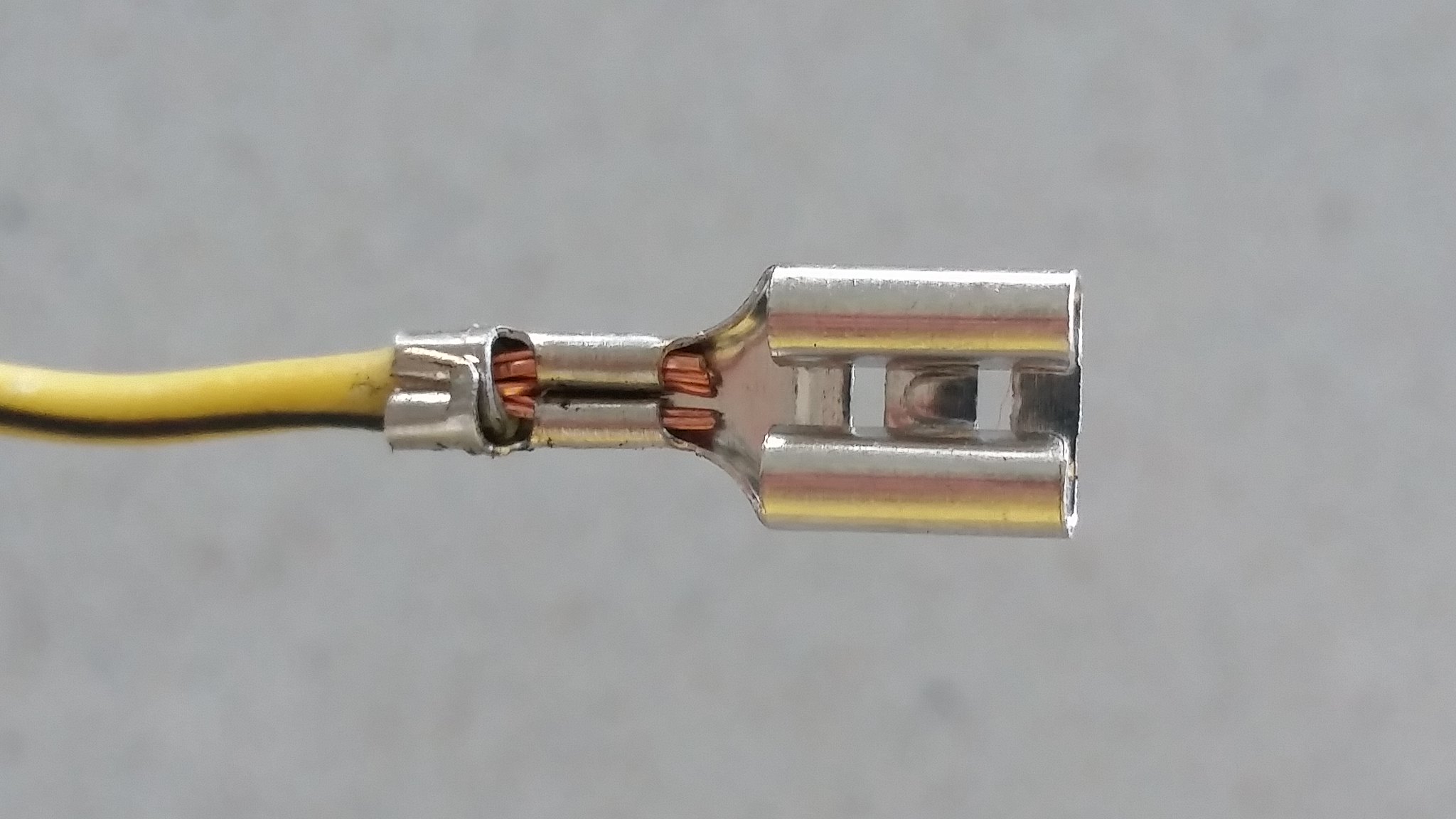

Here's one I made with a runner-up - not awful, but not as nice. Life's too short for crappy crimps, I always say:

[MENTION=198376]4Runner4Leon[/MENTION] - where did you buy the crimpers BTW?
EDIT! NVM - looks like the same site!
Coming from the 5th gen crowd here! Just want to say that my OCD is so happy to find this thread LOL! These terminals look like what I find on the 5th gen so I think I have to put in an order for a bunch!
Yeah, these terminals are great, and the price can't be beat!
As for the crimper, I bought the Engineer brand from Amazon - ENGINEER pad-02 Precision Crimping Tool kit, Orange - - Amazon.com
