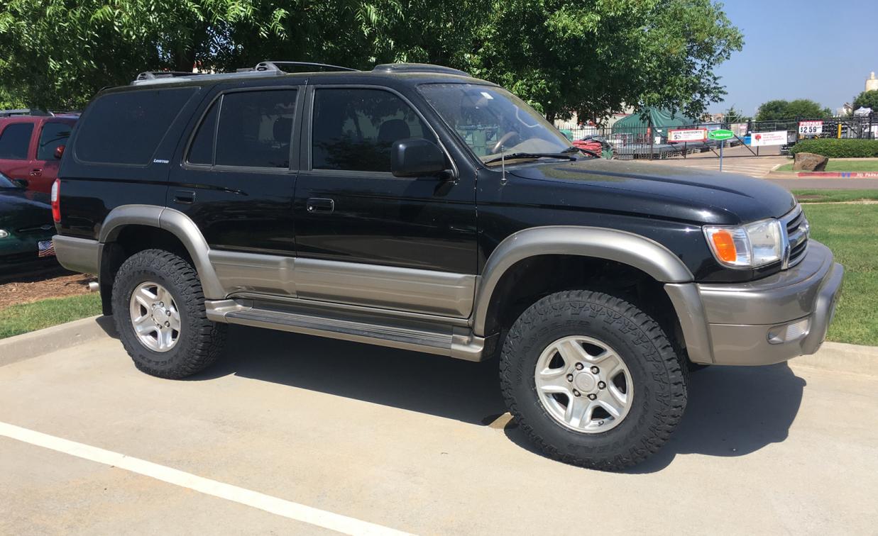

I have currently purchased Bilstein 5100 struts for the front of my 2000 4runner, and have purchased rough country 5100 shocks for the rear as well. I do not plan to do any wheeling or much extreme off-road driving. I purchased it because the dad life has caught up to me finally. Anyway after my math for both front and rear shocks/struts plus the rear spacer it is right under 500 bucks. After all my research this is for sure the "best cheap" lift anyone could possibly piece together. Or did I miss something out in the interwebs?
I would like to achieve a 2.5" front/ 2" rear lift on my 4runner just as I have on my Tacoma. The only difference is that on my Taco I have n3 extended struts up front and n3 extended shocks in the rear.
I have nothing but great things to say about these RC suspension components. Very comfortable considering I am running 2 inch rear supreme suspension blocks in the rear. The fronts are lifted 2.5" shocks that utilize the factory spring to get you said 2.5 inch lift up front.
Finally to get to my questions. I am on a budget :hello:. I plan to run the front Bilstein 5100's my factory front springs at the 2.5" setting. For the rear I plan to do a supreme suspension rear lift spacer to pair with the extended rear 5100 shocks.
Is it a bad idea to run the front Bilstein 5100's at the highest setting with factory springs? Will it get me the desired 2.5 inch lift up front?
Also for the rear what size spacer must I purchase in order to get said 2 inch lift in the rear?
The goal is to purchase 285/75/r16 Achilles X-MT (great/quiet underrated M/T) tires and want it to sit close to the way my Tacoma sits (minus the 17 inch wheel). Pic below to illustrate.
Any help would be greatly appreciated.

Exactly how much of a budget?
I’d spend the $200 and get a set of OME 890’s or 906’s for the rear rather than put in a spacer.
If you want 2” lift with a spacer, then you’d need a 2” spacer.
I think you’ll probably run into much more spending when you tear into a 20 year old rig. Most all the rubber will be shot. Stuff will be worn and rusty.
OEM lower ball joints will run you another $200.
I think what you are proposing can be done.

There are no rear springs between those. You could put 906s on and put a small spacer in there. I have 890s I like the little bit of rake and the spring rate is less than the 906s so they're a little softer and when there's weight in the back it stays level. You may want to consider saying closer to 2" of lift because as you approach 3" you start needing to level your panhard bar, and will need extended bumpstops and extended swaybar links. I thought when I did my lift I wouldn't need those but for me, I wanted a better ride and all these things really helped.
D-C has called it. Once you take apart a 20 year old suspension your budget is likely to go out the window. Unless you like doing jobs twice, now is the time to get things right. I kept the lid down on my suspension refurbish and was still in for about $1200 in parts for my 2000 LTD.

This equated to about a 2" lift, maybe a tad under, which resulted in just after a few months driving both front inner boots split open and dumped their grease. So you can add roughly $120 to that for a new boot kit.
It was all worth doing. (Disclaimer: only pic on hand, poor truck is filthy. 2" lift means up from where it had sagged down to. I'm probably just a tad over original factory ride height.)
Okay I think I'm going to go with 906's. Thanks for your advice my man.

Oh trust me I am 1000 in. 200 more for the springs here in a minute so make that 1200.
I so far since purchasing the rig on Friday have ordered
Front brake pads (monroe ceramic)and rotors (brembo)
Denso spark plus
Denso wires
Denso air filter
Wix fuel filter
Moog inner and outers plus rack boots
Oem LBJ
5100s front and rear.
I had a 4k cash budget for a dad mobile do these purchases make it nice knowing my rig will be reliable for years to come &#55358;&#56606;&#55358;&#56606;. Only had eyes set on a 4x4 3rd gen 4runner because of my love for my tacoma. Got nine for 2600 with 253k miles with paperwork for a recent timing vent water pump and tensioner pully about 6k miles ago! &#55357;&#56846;
