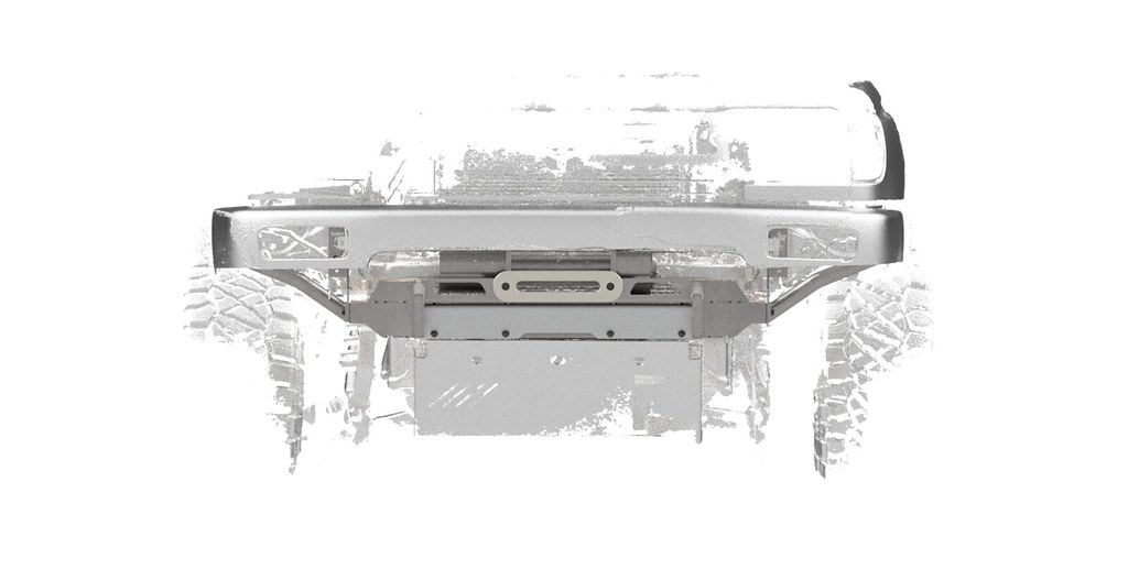

Render of the LB3R with factory OEM 96-98' Upper bumper (ignore the tweak in the bumper we had scanned!)
!PT4 - Truck Assembly For Forum 2 by Tamarack, on Flickr

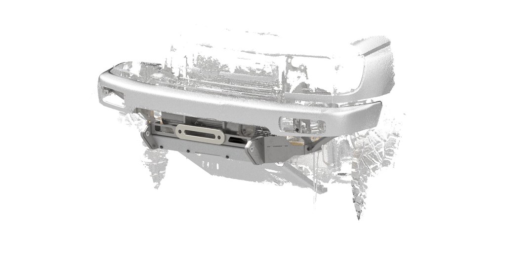

Render of the LB3R with our fully design UB3R:
Untitled by Addison Rickaby, on Flickr

Below is the first post when we starting talking about the design. We have received a ton of great feedback from forum members on how to make the product better - props to the 3rd Gen 4Runner community, you guys rock!
Hey Guys/gals,
Long story short, we've (Tamarack) been working on a OEM+ bumper design for the 3rd gens for ~6 months.
Background & Goals:
We've built a lot of trucks and ran a lot of aftermarket bumpers, and ran a lot of different camping/wheeling configurations, and we seem to be constantly trying to simplify (lighten?) our truck(s) as time and experience continue. I often compare the 4WD scene (I hate the word "Overlanding") to the mountain bike scene - bikes started out beefy and heavy and built like tanks, but as the technology and time has passed, bikes have become more evolved, more advanced, lighter, and stronger. Our goal with this project was:
A) Provide a winch mounting point (duh)
B) Incorporate recovery points that are more or less in line with the frame rails (reduce the lever-arm effect during a recovery - lots of bumpers have the recovery points mounted too high/offset from the frame rails IMO)
C) Make the bumper fairly modular and allow for different user groups to spec it to their uses
D) Try and tie in to the OEM aesthetic as much as possible - "thus OEM+"
E) Keep weight down to a minimum
Below is the prototype that we will be cutting in the coming weeks and I will be running on my 4Runner.
A couple interesting points about the current design:
- Approx 50lbs using the factory chrome 96-98' bumper
- 3/16" steel
- Will be a Weld-It-Yourself kit with most of the major components being pre-bent. This will minimize welding, increase the consistent level of quality of appearance for bumpers out on the market (varying degree of welder skill), and allow a flat-pack/cheaper shipping.
- Lower front skid bolts on, so access to winch mounting points will be a breeze
- We will be making brackets to house 2x LED pods in the factory turn signal locations
- Accommodates 0 and 1" bodylifts into one design and it can be interchanged back and forth
- We will later be producing a full aluminum/steel replacement for the OEM chrome bumper valence, that will be a direct swap, but modernize the OEM design while increasing strength for the more hard-core user
We are a ways out from production on this and still in the prototype phase. I wanted to throw this out there to the awesome T4R forum community and GATHER SOME FEEDBACK.
- Would you buy a bumper like this? (pricing still in the works - will know soon)
- Any thoughts, ideas, questions, or recommendations on the design?
(please ignore the slightly bent OEM chrome bumper I had scanned... it should straighten itself out when I bolt everything up ;)
!PT4 - Truck Assembly For Forum 1 by Tamarack, on Flickr
Thanks for your time!
Addison

hey. i am looking out of the corner of my eye for bumpers to replace the OEM one but that aren't the full-on bull bar or TJM-style stuff. slightly more refined and not quite as giant; i don't really want to upgrade a ton of components just for this. i do want something that will protect against deer, which we have in spades here. it would be nice to have something that won't look dramatically different from the OEM bumper, but 'just enough' so it's not looking like a rebuilt fat lip bumper.
that said, i'm curious to see how your design evolves, and i wonder how it would integrate the OEM bumper and still offer protection for the headlights, grille, condenser, and radiator. we totaled a subaru this way, and i really don't want to lose my baby (my 4R) to another deer. do your modularity plans include the possibility of adding on a refined (loaded word, sorry) bull bar sort of top portion?
another consideration: i am no welder, and frankly don't like my neighbor (a professional welder) enough to beg for his help. would you consider an option for supplying a bare but welded product, if the customer were to supply as many exact measurements as you need?
edit: my bumper is a little bent just like that. makes me feel like i was looking at a scan of mine :-) oh and a winch mount wouldn't be in the cards for my 4R; i have a truck i go beat up on the trails. would it be straightforward to offer a no-winch option?

Second on adding a front receiver hitch. For folks who are allergic to weight having a receiver mounted winch is a great solution.
Will this be compatible with typical aftermarket skids (like Savage)?
Addison- Love the design, as I'm a sucker for OEM designing. You just can't beat the stock lines of these trucks, and this bumper helps preserve that while also giving the needed clearance.
Really looking forward to checking out production versions. I've got a 2000 fat lip, so curious about how that may work out in future revisions as well

How bout incorporating a 2" front receiver option?
Never thought of that. I'd say it wouldn't be too hard to incorporate behind the lower front skid area (so it would be hidden). If demand is enough, I think we could incorporate that.

Will these fit the 99+ years? 1999-2002.
Awesome stuff!
I'll try and answer both comments here. I agree on the classic/timeless lines of the 3rd gen. Definitely trying to preserve that in the design, so I'm glad you've noted that.
- My truck is actually a 00' 4Runner, so yes it will fit with 99-02' trucks. Our thoughts are that if you want the lightest possible version - you buy our bumper kit and source a 96-98' bumper to work with it. They are ~$100 on RockAuto for a new one or you can source one from a wrecker. This ensures the bumper fits all 96-02' 4Runners.
- Alternatively if you have a 99-02' we will soon be offering a fully fabricated replacement for the 96-98' "chrome bumper" that will bolt to the same mounts. This can A) either be an optional upgrade path for people or B) they can choose the fully fabricated version from the start if they don't want to run the flimsy 96-98' bumper.
- I also know that the 99-02" fat lip bumpers have a very similar mounting point to the 96-98' bumper. There is a very high possibility (especially if we have the demand) that we will be able to accommodate the top half of the 99-02 fat lip bumper in the same way as we do with the 96-98' bumper with some tweaks to the mounting points. Our thinking initially was that the 96-98 bumper looks better (especially when we have the brackets to mount 2x LED pods in the turn signal openings) and it natively has a greater approach angle than the 99-02 bumper.
Hope that makes sense and answers your questions!

If I understood you correctly, your bumper will bolt directly to 99-02 mounts without modifications?
Not naming any names but will your bumper have any love for 3rd gens with 2" body lifts?

You will need to trim the flaps on the end of the frame rails. Similar to the Coastal Offroad bumper installation. It's literally a 5 minute job with a grinder and no structural components are removed. We would be including all of this information in the installation video & instructions but otherwise it's a factory fit. We will be recommending that a single hole be drilled through the frame rail as an additional through-bolt. It will install without it but it will be recommended.
2" bodylift was an initial consideration. We like that nothing changes on the bumper itself between the 0" and 1" bodylift trucks other than which holes you use to mount up the OEM bumper skin to. We stopped at 1" because making the mounting points work for the 2"+ bodylifts all within the same mounting bracket, started to ruin the aesthetic when used on a non-bodylift truck (this will be the primary market). So at this time, no options for a 2" bodylift but if we get enough requests it could certainly be added to the line-up later.

UPDATE
A couple notes…
I’ll post pics of the receiver tube cutout below the winch plate when I get back on my computer.
Bumper had to have a fairly large revision once showing the plans to the shop who will be manufacturing them with us. Aesthetically it will barely change but that’s where the delay is coming from on my end.
Hoping to have the #1 cut in the next 10 days.
Next steps:
- Begin working on the “fat lip” version for the 99-02’ OEM bumper valence
- Complete the full “off-road” replacement version (will be available in both steel and aluminum) and will be interchangeable on the bumper with either of the factory versions (so you can even upgrade later if you want)
- Work on brackets to mount LED pods in the factory turn signal locations on both the 96-98’ and 99’-02’ bumper variants
Also have a slider design that I’m just about done. I will share that pretty quick here as well to gather some feedback.
