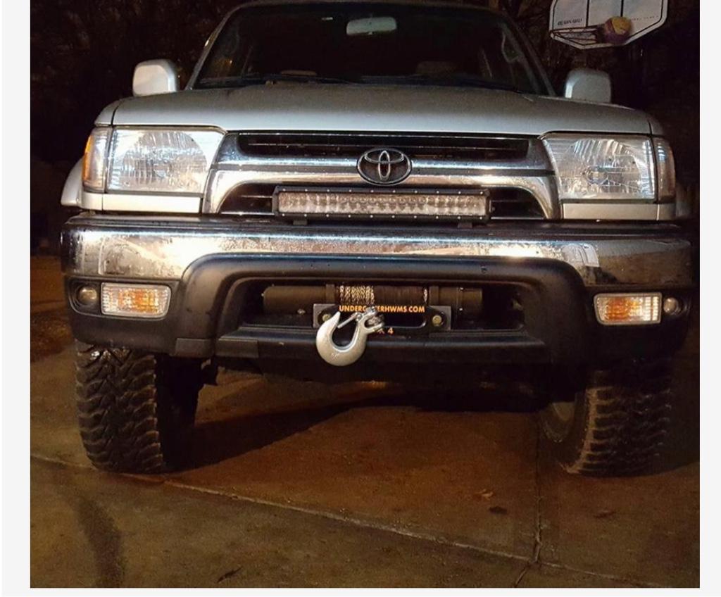

I love the goal of low weight of this design, and weight is probably the #1 reason I haven't installed an aftermarket front bumper and winch. Since I have the Fat Lip bumper, I suspect that economics/cosmetics would drive me (personally) to go in a different direction than the Rickashay bumper, either to the semi-low weight Trail Gear Rock Defense 1st Gen Taco tube bumper, or to a custom hidden winch mount option. BTW, if someone developed a hidden winch "weld it yourself" kit, or non-weld kit for my 2000, I would send them a check today!
I agree. I don’t want to thread hijack, so here’s a link to this thread: Winches under factory bumpers?
Love how clean that setup is ^. Low weight and factory looking - huge props! Only downside with the fully hidden options is they don’t do anything for you in approach angle and clearance. Probably their only drawback IMO other than the looks category (subjective). I kinda hope we fall right in the middle between a “beefy” aftermarket bumper and being fully stealth mode like the link above. Thanks for sharing the link for other curious about going that route.
