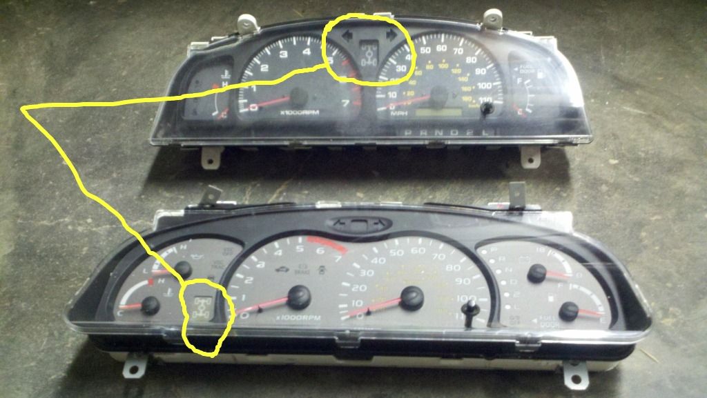

As everyone who has read this thread knows, or I think they know, I kept all the creature comforts of the AWD system.
I kept the Limited's Transfer case ECU and grafted it to the Sequoia's Transfer case.
Wicked cool set up. Push button AWD, Push button 4 wheel drive and manual Hi Neutral Lo stick.
Anywho, The system worked great when I did my conversion. But last winter, I wanted to use the AWD and the dreaded blinking 4 tires showed up. I was bummed out. Now the 4x4 button worked but the AWD caused the blinking light.

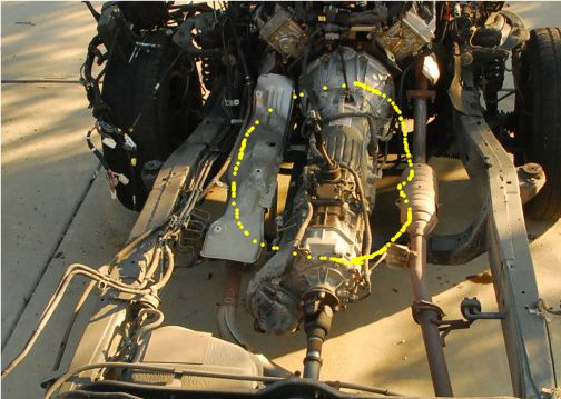

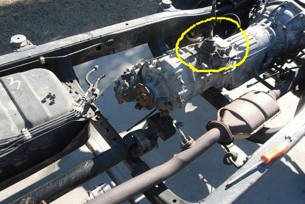

The original transfer case was a j shift with awd push button. Pull the transfer stick pack and it locked the center diff.
I did not use a Multi Mode transfer case out of a 01-02, I used the Sequoia transfer case because of the stick location. It was more forward than the 4runner's so when I pushed the engine back, it put the transfer case stick in the correct spot in the transmission tunnel.
4runner transfer case
Sequoia Transfer case

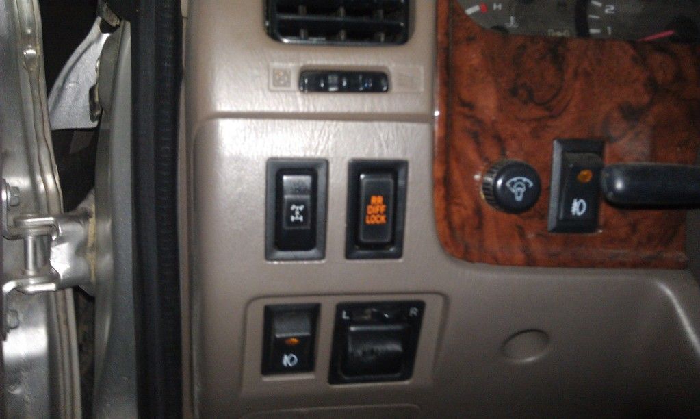

The weird thing is that the Sequoia has no option of locking the center diff. The ECU will lock it only when the shifter is in 4lo and the gear shifter in 2nd.
So with the use of the 4runner's 4x4 ECU and a center diff lock switch, I am able to use the Sequoia's transfer case in AWD and Center diff locked at the push of a button.
I could have used a tundras transfer case as they are totally electric, no stick but i did not have one to use, plus I already had a sequoia transfer case in my possession.
