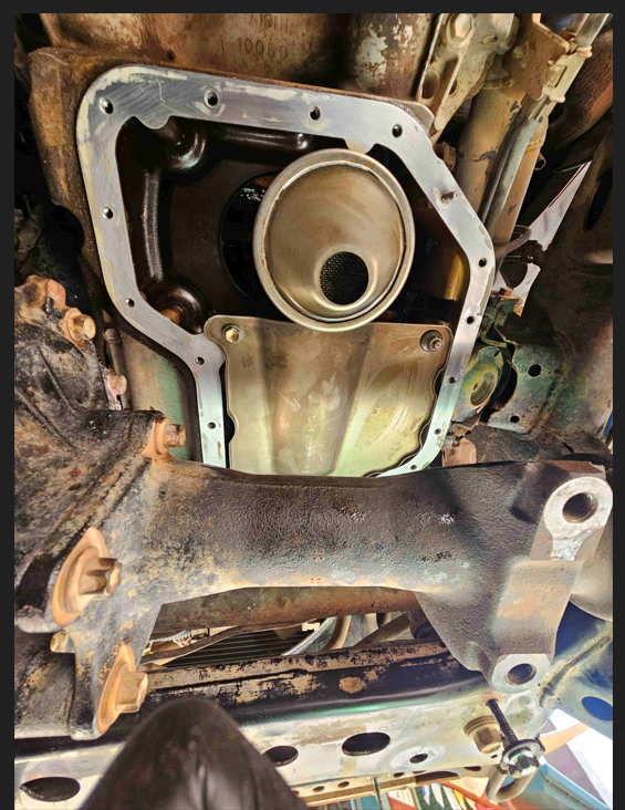

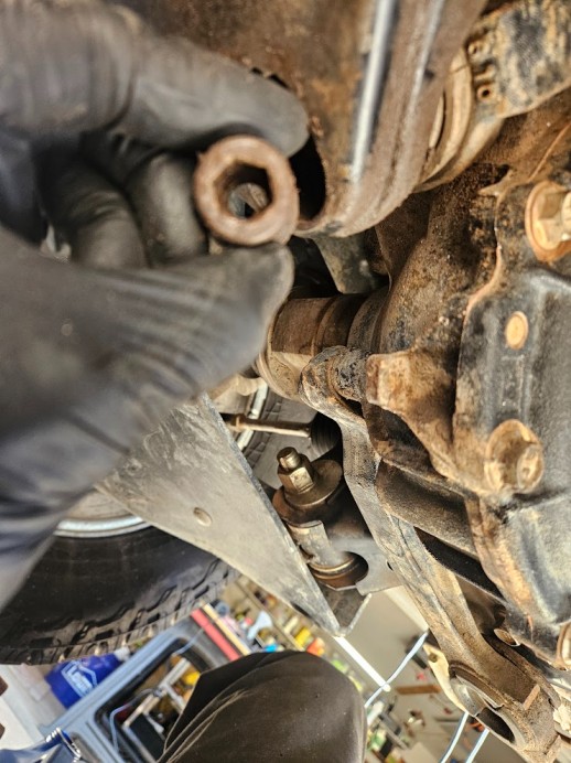

It's time for an update. I disconnected the entire tcase and transmission harness in prep for the engine extraction, and that's when I decided there's no f'ing way I'm going to go that route. Separating the engine from the trannny was going to be way too much effort for this guy. It's a tight fit and my body ain't gonna like that abuse. So, last weekend I reconnected the entire harness back up (15 min), then started on the lower oil pan resealing project.

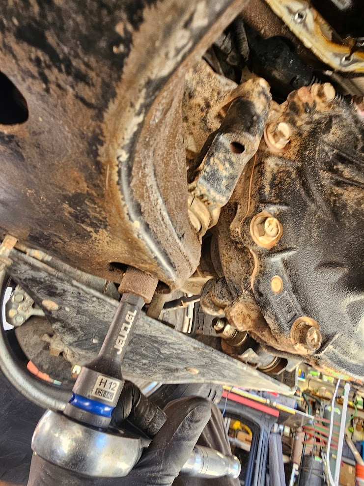

So, i removed the leaky lower oil pan, resealed it up then reinstalled it. That was pretty easy. The only different I did was to apply the sealant on the upper oil pan vs on the lower steel oil pan. Maneuvering the lower oil pan with sealant on it was too much of a PITA for me so I went a different route. I did loosen the front diff axle tube so that it flopped around some and rested naturally at its lowest position. This allowed a tad bit more vertical room for the lower oil pan to be spun around, then tilted this way and that before coming out.
Tips:
- one of the diff mounting bolt is a 12mm hex head so i bought one from Amazon. I don't think you'll need to remove this allen socket nut but I did it for the hell of it. It mounts the rear end of the diff to a swivel mounting thing. Doing this made the front diff a tiny bit more floppy which allowed it to rest against the pass LCA. Up until this point, I had to use a large C clamp for woodworking to clamp the pass CV axle to the pass LCA. Every little bit helps as you know!
-Also, remove both diff and diff tube supporting arms. These are 21 mm bolt, and 19mm nut up top. Easy peasy with a rattle gun. The torque on this hardware is stupid high so prepare for that fun times.

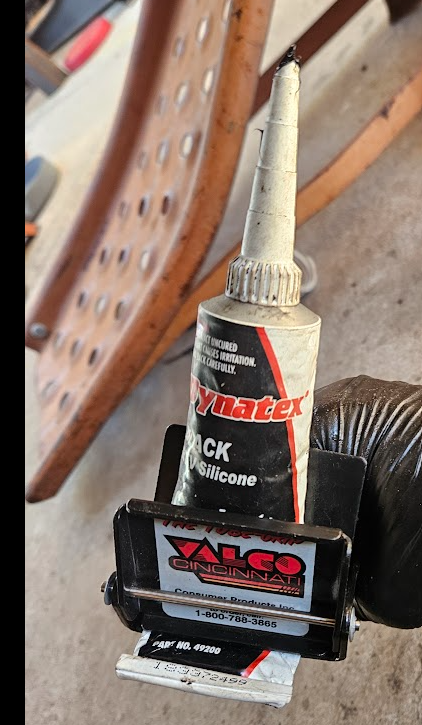

-Another tip is this awesome "tube squeezer" tool. FIPG from Toyota and my RTV sealant come in a toothpaste like tube, and using this tool with one hand while applying the RTV on the underside of the engine was pretty sweet. FIPG from toyota comes with a winding tool like a can of sardines but that requires the use of two hands and it's tiring. This tool from Amazon is badass. Mine is Valco brand made in the USA.

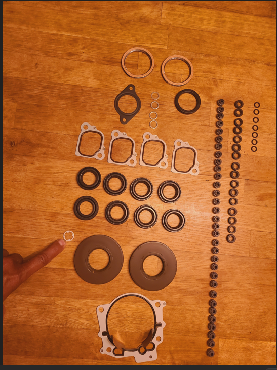

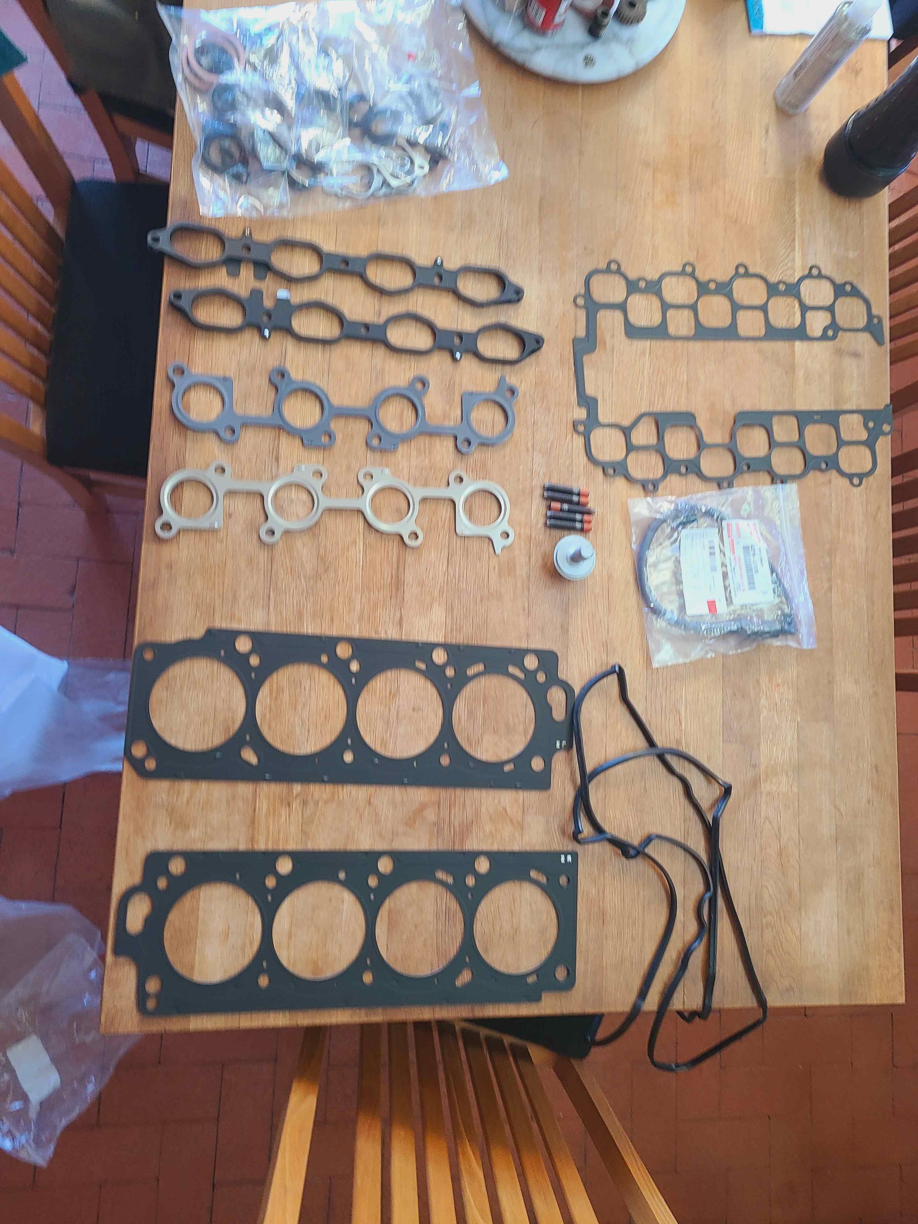

Toyota valve regrind kit (basically a head gasket kit).
This is an extensive kit from Toyota and it has everything needed for this job. The beauty is that this mess of parts is just one part number! 04112-50180, cost $290. I made a spreadsheet of all parts needed for this project, and some of them are coming from Amayama in Japan. The little white metal washer I'm pointing to is my reminder to ask the Toyota parts counter guy. They don't think i need this washer for the 2uzfe project.

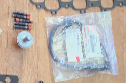

Third pic shows the crankshaft bolt, some exhaust studs, and the knock sensor harness.
