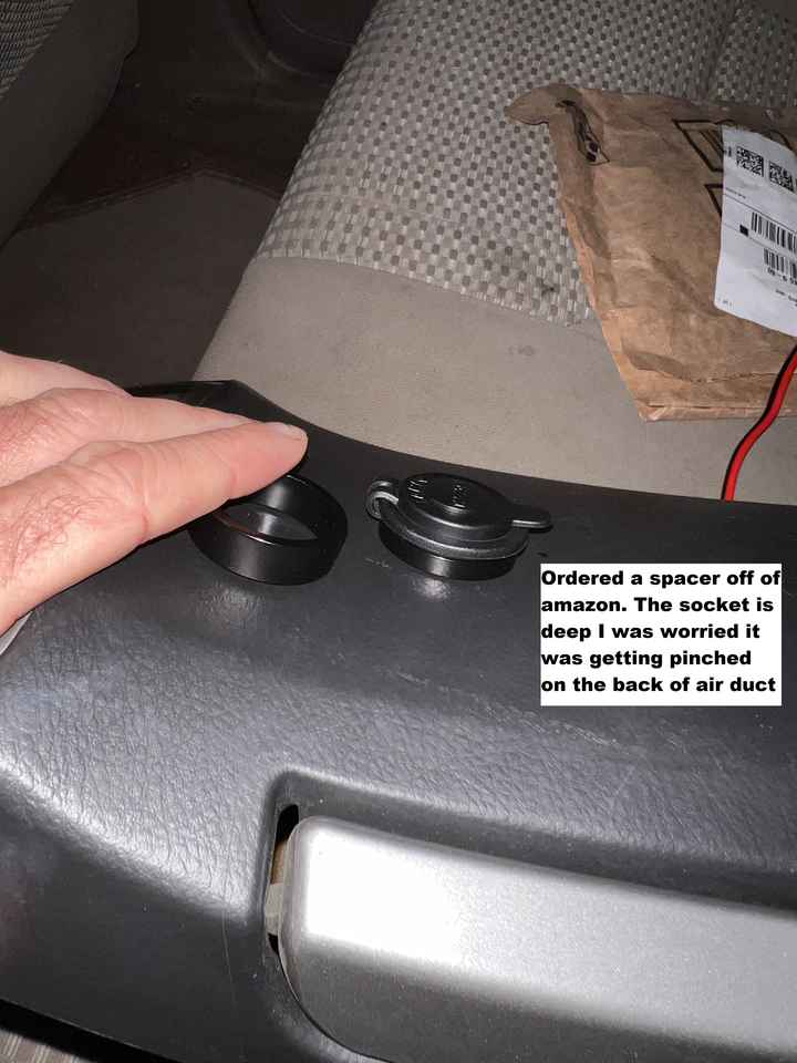

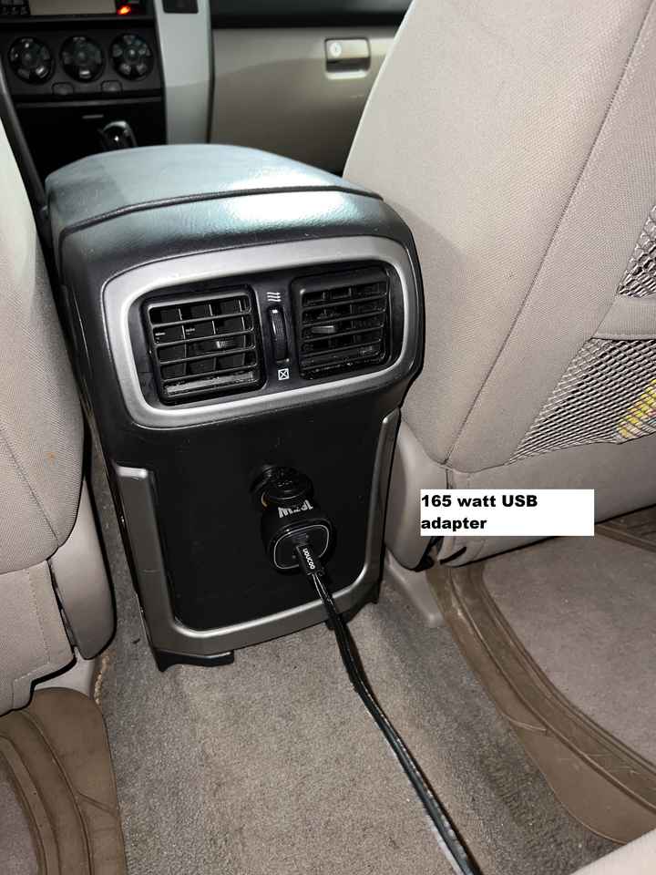

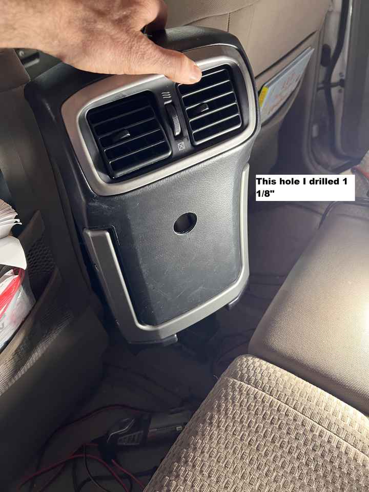

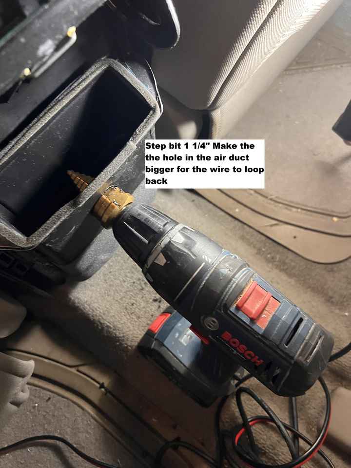

Rear seat Cigarette Socket Car

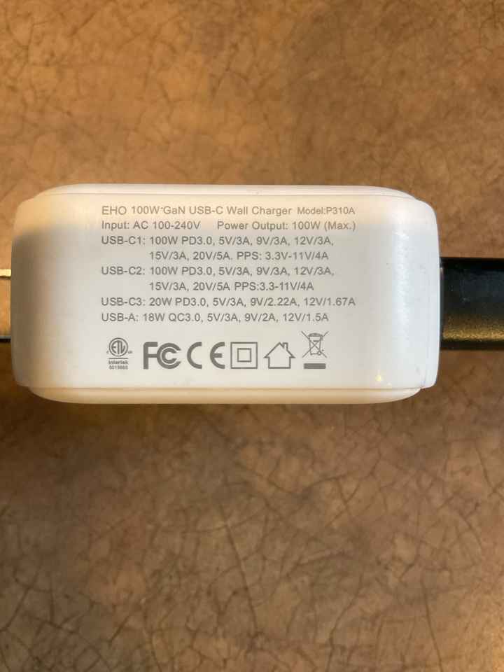

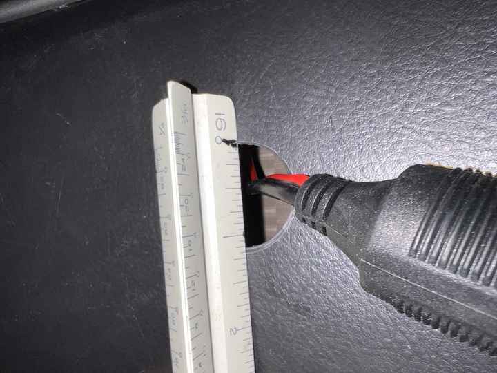

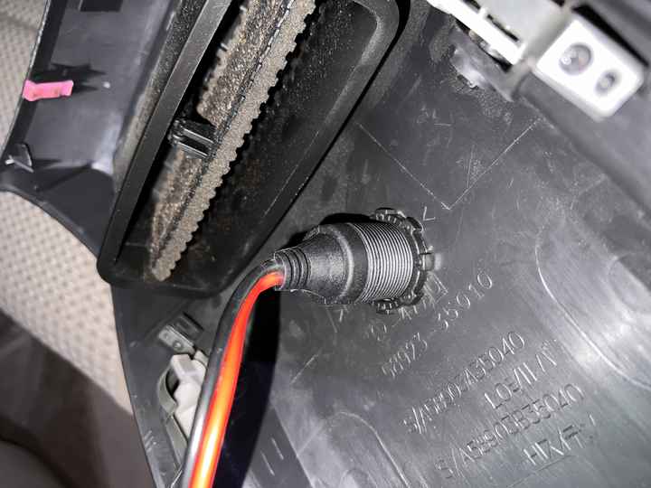

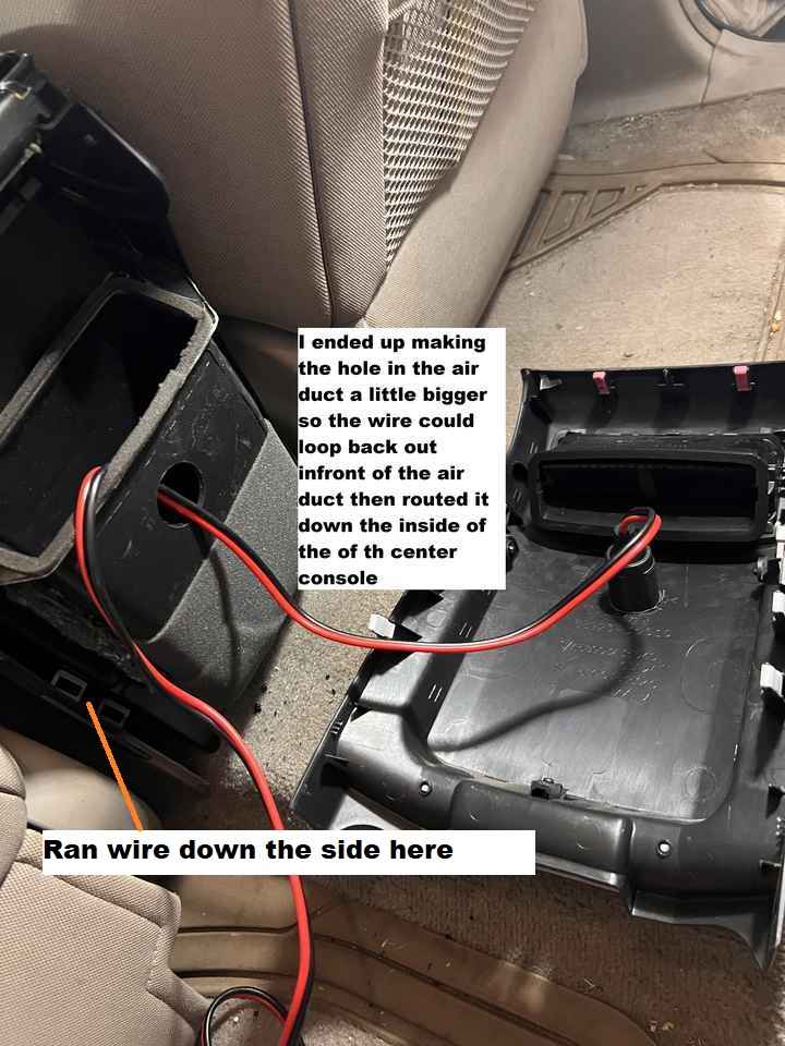

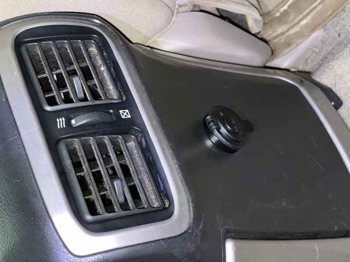

I just finished this mod on my 2007 4runner. It was inspired by this thread. I went with the cigarette socket because it seems like you can get the USB adapters with higher outputs then all-in-one USB sockets. In addition, the cigarette socket is someone future proof. USB ports seem to keep changing. In addition, the kids can plug their LCD TV screens on the back of the heard rest into this which have a cigarette socket type.
It wasn't the cheapest solution but this mod is made out of high quality parts and it is 12 awg wire all the way from the fuse tap to the cigarette socket. I don't mind spending the extra money if it is quality and looks nice.
I'm looking at adding a AC port next. If anyone has pictures of how they did it, send me a message.
Cigarette Socket 12 AWG (Amazon)
Fuse Tap 12 AWG (Amazon)
Spacer (Amazon)
Cigaretter socket USB Adapter 165 WATT (Amazon)

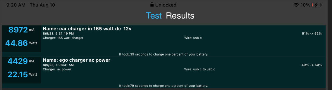

charge test results
I ran a charge test using the new cigarette socket and USB car adapter. The results are good. I used the ampere app and base lined against a AC adapter I have. The eho AC 100w-GaN USB-C wall charger (model: p310a) I have quick charges very well, it was the fastest charger I had in the house until the new 165 watt cig charger. The new 165 watt adapter I installed is twice as fast. Charging my ipad pro in 1% in 39 seconds vs the AC adapter charging at 1% every 79 seconds.
