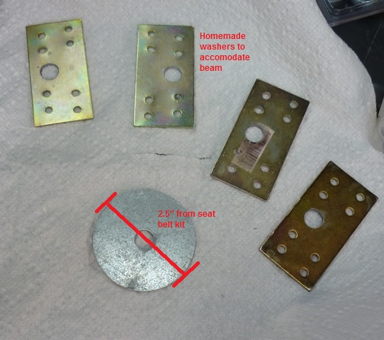

Lastly, looks like your homemade plates are made from door hinges - is that correct?
No. They are just flat pieces of some kind of treated construction metal I picked up at the hardware store.
