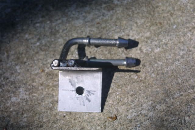

couple pics
#1- Hangar Bracket. Lemme know if yours was like this......\
IMG_8353.jpg~original
#2- Bracket and Rubber. I would need to bend one fo the arms (the shorter) out a bit to make it work...

you need to spin the rubber hangar to the left. There are 2 holes in it that are "connected" with a and one that is by itself the 2 connected ones go on the hangar, the free one goes on the pipe hangar.
