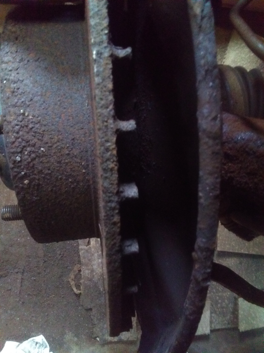

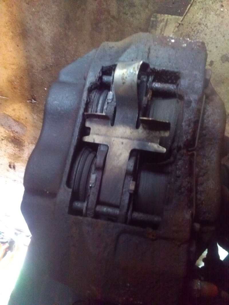

Well the exciting results are in, and we're all sort of wrong!! It does appear that the inner pistons overextended and probably caused the leak.
I haven't taken it apart yet to confirm but...what caused the overextension was not pad wear, what caused it was the inner half of the rotor disappearing itself.
Never seen that happen before and am not anxious to see it happen again. I'm not sure how it could do this without me noticing, but it did. Stealth rotor disintegration. :oops:
So now the question is what's the best easiest cheapest plan of action? Suggestions welcome. I haven't looked to see if they make rebuild kits or whether there are quality options out there that don't cost an arm and a leg and another arm. Fortunately the right side rotor is still in one piece, but obviously will need to go.
