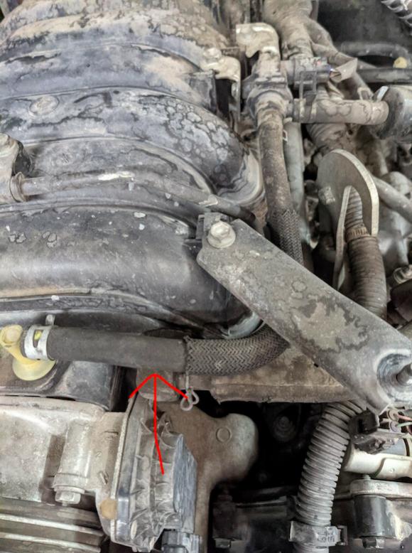

Hi there everyone, I replaced my timing belt this past weekend and discovered one of the hoses on the top of the intake manifold is very dry rotted and a CEL code waiting to happen. Any ideas what the part number is for this hose or what generic hose to replace it with? Thanks! Oddly enough the other hose next to it looks fine!

When you replace that hose be very careful with that plastic manifold barb fitting, they can be very brittle and break easily, it's also glued onto the plastic manifold so replacing it it you break it can be a challenge, I would suggest cutting the hose with a razor knife inline with the fitting where it slides over the barb until it gets loose before trying to pull it off.
Thank you both, really good to know about the connector on the manifold... since it is a vacuum line I suspected Toyota chose to add fun/difficult surprises like gluing in the connector :mad: :mad:
