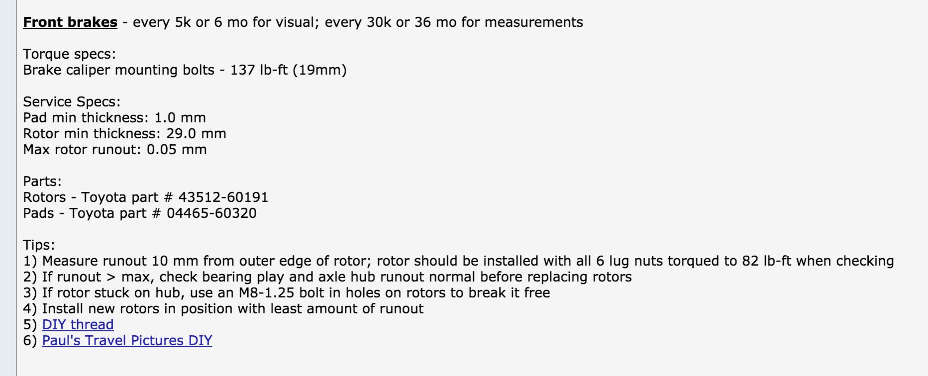

I have read through that several times and I did not see the torque specs for the bolts that hold the two halves of the front brake calipers together.
I do see the specs for the front brake caliper mounting bolts, which are different that the four bolts I am looking for the torque spec for.
Did I miss something (even after reading through it four times)?

You're not missing it in that post. Are you rebuilding the calipers? I know what bolts you're talking about, but I can't find the spec in my manuals. I may be missing some sections.
As mentioned, these are the specs for where the caliper mounts, not the four bolts that hold the two halves of the front caliper together. :)
Thanks for the try anyhow. :thumb:
