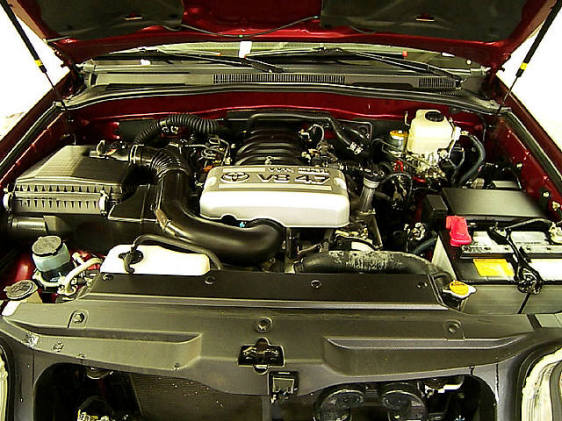

Quote:
Originally posted by drmorbius
There is a thing that looks like a metal bottle called a receiver/dryer which has a sight glass in the top and is usually mounted somewhere near the A/C heat exchanger(radiator). There may be a rubber cap over the sight glass which just pulls off. You should see flow across the sight glass but if you see bubbles it means you have lost some of your charge. Hope this helps.
Can u post a pic where this is at?

Quote:
It's in the underhood fuse box on the battery side. Simply turn over the lid of the box for placement.
i'm still confused. Now where over here?
Sorry no bottle. On mine the sight glass is in front of the radiator between a pressure switch and a service valve on the left side when you are facing the radiator. I have a V6 so not sure where on V8. It's part of a silver colored line that goes to the bottom right side of the radiator, again facing the radiator.
