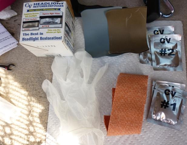

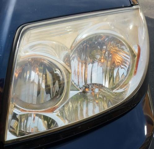

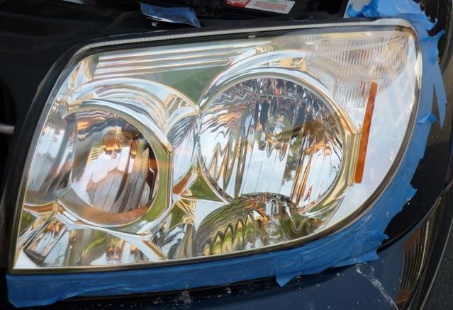

So I used the CV headlight restorer over the weekend. Wow! This stuff works great and the headlights look better than they ever did using the Meguiars. I took a before and after pic. The headlights really do look new.
I think it is the sealant that really does the trick.
I followed the directions but here are a couple of tips.
  • Open the hood and use tape to mask off the paint. A few times my hand slipped when using the sand paper.
  • The CV #2 is a liquid comes out Fast! (CV 1 is a paste).
  • You can get an idea of what the headlight will look like towards the end when you clean it with water. The CV #2 fills in the microscopic gaps like the water does when you clean the lens.
Before and after pictures
headlight oxidation-headlight-before-jpg  headlight oxidation-headlight-after-jpg  headlight oxidation-headlight-kit-jpg

Quote:
Just thought I'd post a follow-up. It's been more than 3 months and the headlights still look new with no change from when I took the pictures above. If anybody want's to solve the headlight oxidation problem permanently, this is the solution.
A follow-up to my follow-up. All in all, the fix lasted about 1 1/2 years before I had to use the plastic polish. The 4runner was always parked outside and never garaged. Rather go the CV route again, I just purchased new OEM headlights and installed them - just a couple days short of the two year mark when I first posted my results from using the CV headlight restorer.
