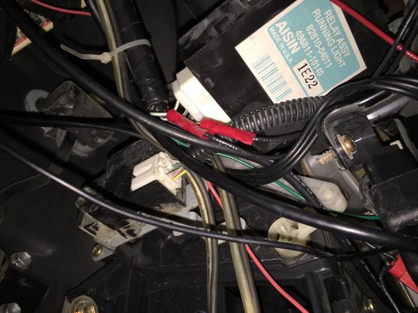

Some have a gray box, some have a black box. That's where you'll find the Black/Yellow cable to cut. Ignore the wiring nightmare at the moment. I

all that to disable the lights? i just removed the wire from the harness. no problem.
True. Removing the wire from the harness or flat out cutting it works just fine. Personal preference, really. I wanted the ability to control them from a SPST switch. Had a few extra minutes and all the parts I needed.
