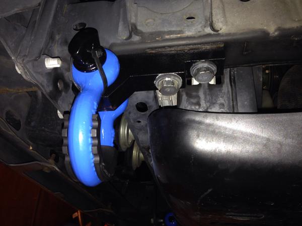

trackdecal.com shackle brackets. 3/4" D-Rings, Daystar Isolators, 11" zip ties and a little sky blue rattle-can paint.
I filed off any sharp barbs or edges off the D-Rings where the recovery strap might get snagged, gave them a quick sand, 3 coats of primer, 3 coats off paint and two weeks to dry. By the end of winter I'm sure they will be nice and dirty!
