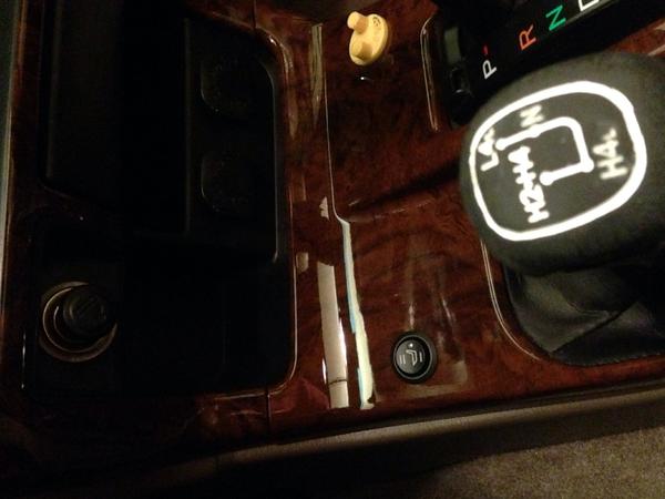

Left seat heater installed. Drilled the hole for the right seat heater while I was at it and plugged it for now, hence the oil filler cap. These are

No. The seat covers needs to be separated from the cushion and the heater mat placed between them. Slow and steady. The units come with a black and red wire for the hot and the ground. I found a ground near the fuse box and the hot was added to the fuse box with an add-a-fuse. The switch comes with the unit. Wiring is the easiest part. It's not hard, I just figured it out as I went along
